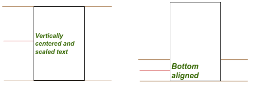

setVerticalAlign() static method
public function setVerticalAlign(textField:TextField, valign:String) : void
Scaleform version: 4.0.12
Sets the vertical alignment of the text inside the text box. Valid values for the property are the following constants declared in TextFieldEx class:
    public static const VALIGN_TOP:String   = "top";
    public static const VALIGN_CENTER:String    = "center";
    public static const VALIGN_BOTTOM:String    = "bottom";
If the property is set to center then text is centered inside the text box, if set to bottom, then text is at the bottom of the text box (see picture below):
The default value is top
Parameters
textField:TextField - A textfield to set vertical alignment
valign:String - Alignment value ("top", "center", "bottom").

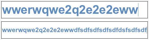

setTextAutoSize() static method
static public function setTextAutoSize(textField:TextField, autoSz:String) : void
Enables automatic resizing of the text's font size to shrink or fit the textfield. Valid values for the property are the following constants declared in TextFieldEx class:
    public static const TEXTAUTOSZ_NONE:String      = "none";
    public static const TEXTAUTOSZ_SHRINK:String    = "shrink";
    public static const TEXTAUTOSZ_FIT:String       = "fit";
If the automatic text resize value is shrink or fit and if text doesn’t fit in a text field then size of the text will be decreased proportionally to fit whole text in the text field, thus, no scrolling is necessary. If text size becomes too small (font size is about 5 pt) then the default scrolling logic is still used and no further font size decrease is performed.
Setting the text resize value to fit mode will enable increasing of the font size until the text field is filled with text. Shrink mode can only decrease the font size when text doesn’t fit in the text field; the original font size is not increased.
