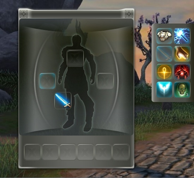

Figure 64: DragDemo in action.

Scaleform CLIK includes a sample IDragSlot implementation called DragSlot (scaleform.clik.controls.DragSlot). The DragSlot extends UIComponent and thus is classified as a CLIK component. It has several unique features that complement the DragManager. The DragSlot is designed to contain a MovieClip/Sprite/Bitmap that will be dragged. However, DragSlot also mimics many of Button’s behaviors that allow it to also be used as a Button.
The DragSlot has a concept of drag types. These drag types can be configured per DragSlot to enables the component to allow or disallow a drop operation. To complement these drag types, the DragSlot also installs event listeners for dragBegin and dragEnd with the DragManager. This enables the DragTarget to visually display whether or not it can accept a drop operation.
Ultimately, DragSlot is merely a sample implementation of IDragSlot and many of its functions have been stubbed out to be replaced sub-classes that communicate more closely with a data backend. For a sample of a fully-featured DragSlot subclass, take a look at the MMO UI Kit, which uses DragSlot as the base class for draggable content throughout the UI.
