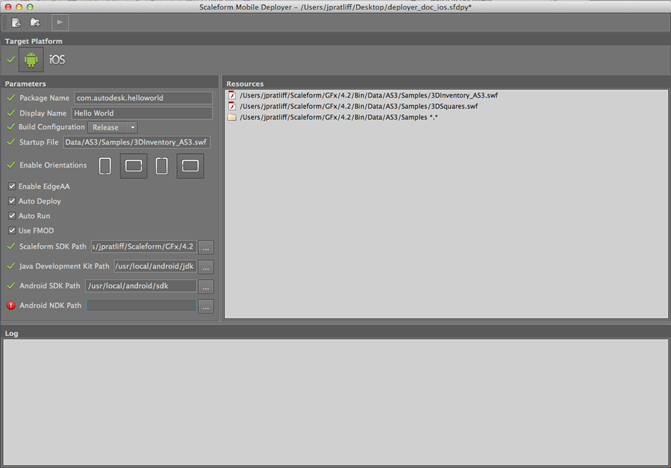

Figure 1: Scaleform Deployer
The tool provides users with an intuitive GUI based project management system and faster iteration when testing different assets and settings. The tool also provides an easier way to manage a project creation process by allowing the ability to save and open the resource entry list and configuration options to a project (.sfdpy) file. The tool can accept a .sfdpy file path as an argument and will open the project on startup. The Scaleform Deployer is available with Scaleform 4.1 and higher versions.
