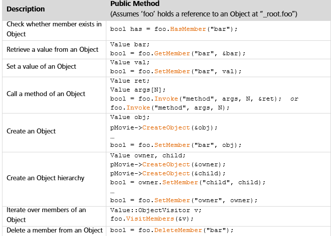

The Direct Access Public Interface
Here are the public member functions in the Direct Access API. Please see the online documentation on GFx::Value for the latest information.
Object Support

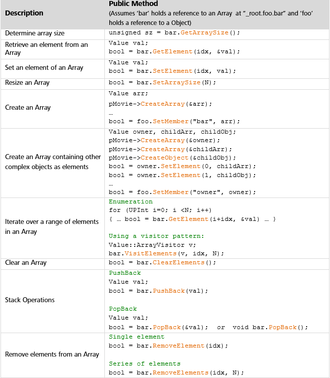

Array Support

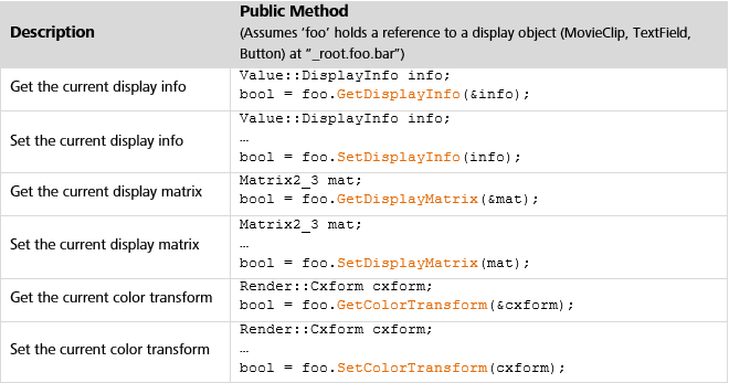

Display Object Support

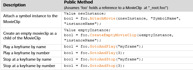

MovieClip Support

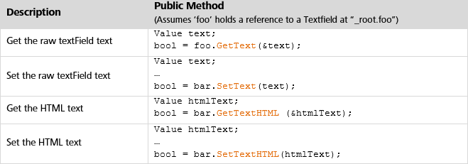

Textfield Support
