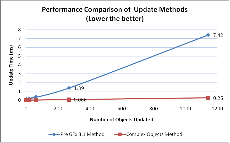

Previous Scaleform implementations were limited to using the C++ GFx::Movie::SetVariable and GFx::Movie::Invoke methods to update a Movie’s view state. This unfortunately incurred a significant performance penalty due to many factors, such as resolving MovieClip paths. In contrast, the Direct Access API provides faster code paths to perform the same functionality, thus making complex HUD updating much more efficient using Scaleform 3.1 and later.
The following graph shows the significant increase in the Minimap’s performance (lowering of the update time) using the Direct Access API method compared to the SetVariable/Invoke method. The performance gain is in the order of 10-25x:
Figure 15: Performance comparison of the Direct Access API vs. SetVariable/Invoke update methods for Minimap
As shown above, the update time of the Direct Access method is optimal for all working environments as it is well below the 1ms threshold – the average allocated processing time for HUD UIs.
