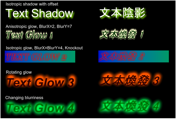

Font soft shadow, blur, and other effects are supported. Simply set the appropriate filters on the text field in Flash to generate the desired effect. Additional details are in the Font and Text Configuration Overview linked to above.
Figure 5: Text effects
