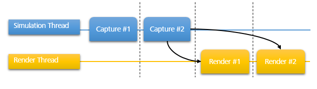

It may not be desirable for the latest snapshot to always be the one displayed. For example, if the simulation and rendering of the application are decoupled, it is possible for two simulation steps to be taken before the corresponding rendering for each simulation occurs. The diagram below depicts such a situation.

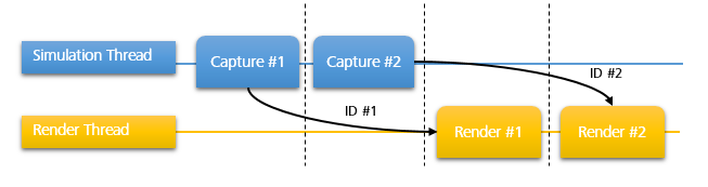

Without the ability to associate Capture calls with NextCapture calls, both Render #1 and Render #2 steps renders the state of the GFx::Movie as it was when Capture #2 was taken. To support applications which require the exact state of the GFx::Movie at a particular time to be displayed, GFx::Movie::Capture returns a snapshot identifier, which can be passed to MovieDisplayHandle::NextCapture call. This will cause the Display call of the same handle to reflect the state of the GFx::Movie as it was when the snapshot identifier was generated. This is shown in the diagram below:
Now, Render #1 will render the state of Capture #1, and Render #2 will render the state of Capture #2, even though the Capture calls both completed before either Render step began.
