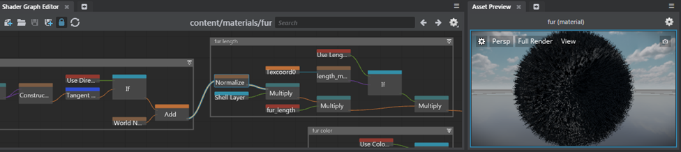

If you'll be doing a lot of work with shader networks, you can dock the Shader Graph Editor in the main interface, for example, next to the Level Flow tab. As you edit the shader graph, the Asset Preview window updates to display your changes. Save the material to force a refresh if necessary.
To streamline your workflow, you can dock multiple shader graphs in the main interface. With several shader graphs open at once, you can easily cut and paste shader nodes between different graphs.
