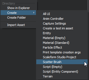

The editor can offer users the ability to create new resources of your custom type in the Asset Browser:
There are two different ways that you can set up the editor to do this:
you can use a generic creation mechanism that relies on the default values set up in the .type file.
you can use a template extension to create new copies of existing assets.
If your type uses the generic creator, each time the user creates a new asset of your type in the Asset Browser, the new asset will use the default values configured for all the fields in the .type file. If a field in your type does not specify a default value, the editor will fall back on the default value of that field's base type.
To use the generic creator, add the generic_creator key to your exported type's editor metadata section, and set its value to true.
For example, the scatter brush uses this mechanism as follows:
// from scatter_brush.type
export = "#scatter_brush"
extension = "scatter_brush"
types = {
scatter_brush = {
type = ":struct"
fields = {
components = {
key = ":guid"
type = ":dict"
value = "#scatter_component"
editor = {
control = "ResourceCarousel"
carouselResourceProperty = "unit"
editor = {
label = "Scatter Brush"
// This specifies that scatter brush should have a creation menu item:
generic_creator = true
// This specifies that .scatter_brush files should be editable using the Property Editor:
generic_selector = true
version = "0.1.0"

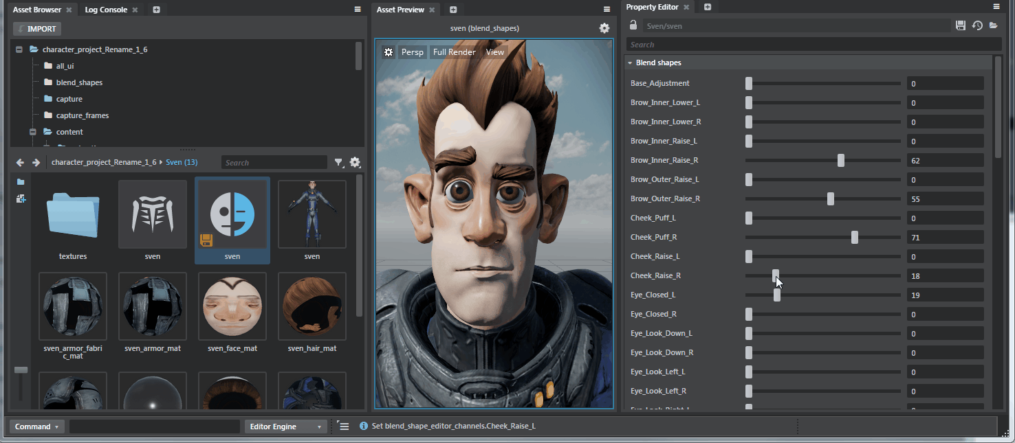

The blend shapes plug-in defines the way users can work with and preview blend shapes in the editor. For background information about working with blend shapes in Stingray, see the main Stingray Help.
Things to note about the blend shapes plug-in:
*editor\plugins\blend_shapes\blend_shapes\blend_shapes.type: The type file describes the data layout of a .blend_shape* file, as well as which types of controls the Property Editor should show for editing its data.
In *editor\plugins\blend_shapes\blend_shapes.stingray_plugin: The plug-in defines an asset_type extension to define the way the .blend_shapes* resource is exposed in the Asset Browser, and a preview extension that defines a custom behavior for the Asset Preview.
Note also that this editor extension is complemented by an engine extension, which handles blending between shapes at runtime.
// From blend_shape.type
export = "#blend_shapes"
extension = "blend_shapes"
types = {
blend_shapes = {
type = ":struct"
fields = {
blend_shape_meshes = {
type = ":value" // :value means an arbitrary JSON value. The type system won't try to reason about it (or to validate it).
blend_shape_editor_channels = {
type = ":value"
editor = {
label = "Blend shapes"
generic_creator = false
version = "0.1.0"
control = "BlendShapes" // Use a custom blend-shape control in the Property Editor, defined in editor/core/components/properties/property-blend-shape.js.

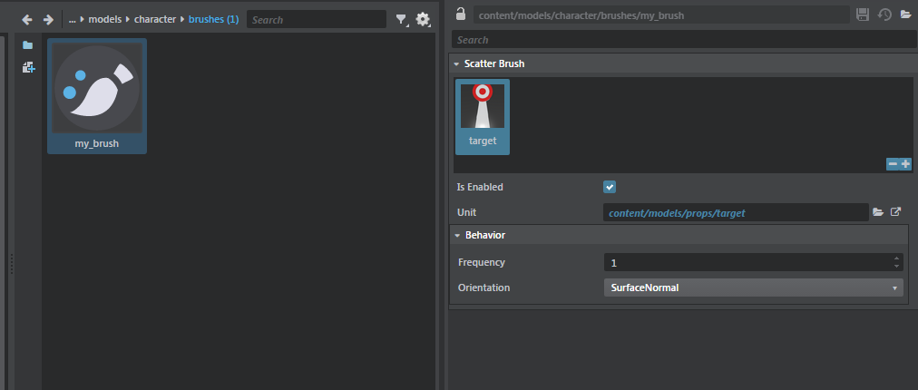

Scatter brushes are resources used only by the editor that encapsulate a list of units that should be painted or scattered on another unit or a terrain. For background information about working with scatter brushes in Stingray, see the main Stingray Help
Things to note about scatter brushes:
*editor\plugins\level_editor\scatter.stingray_plugin*: The plug-in descriptor mounts the folder that contains the scatter.type file, and tells the Asset Browser where to look for its custom icon.
*editor\plugins\level_editor\scatter_type\scatter_brush.type*: The type file defines the UI controls for editing the properties of a scatter brush.
Note also that the levelEditingService listens to changes on scatter brushes to reload the Lua scatter data model, as described under [Listening for changes to an asset] above:
objectEditingService.on("DataObjectsConsensusChanged", function (args) {
if (this.SelectedToolName !== "scatter" ||
!this.SelectedScatterBrush) {
return;
var changeDesc = args[0];
if (changeDesc.AssetsModified.indexOf(this.SelectedScatterBrush) === -1) {
return;
this.invoke('UpdateLuaScatterBrushComponents');
}.bind(this));

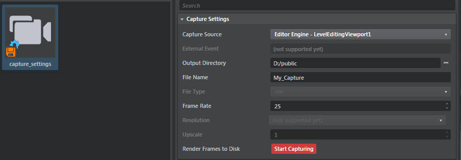

Capture settings are resources used only by the editor that specify parameters for capturing a stream of images from the viewport and saving the result as a set of .exr files. This usage showcases how a custom asset type can make the Property Editor act like a specicalized editing tool. For background information about working with scatter brushes in Stingray, see the main Stingray Help.
Things to note about capture settings:
// From capture_settings.type
export = "#capture_settings"
extension = "capture_settings"
types = {
capture_settings = {
type = ":struct"
fields = {
start_capture = {
type = ":bool"
default = true
editor = {
// Specification of the Action button that kicks in the Capture process.
control = "Action"
label = "Render Frames to Disk"
text = "Start Capturing"
color = "#CC3D3D"
trigger = {
type = "js"
module = "capture_frames/capture_frames_actions"
function_name = "handleCapture"
editor = {
label = "Capture Settings"
version = "1.0.0"
init = {
type = "js"
function_name = "startCaptureSettingsEditing"
cleanup = {
type = "js"
function_name = "endCaptureSettingsEditing"
