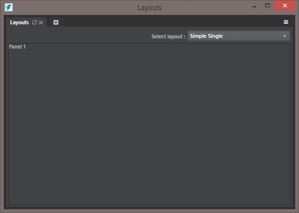

Container
Simple panel used as a container for direct content. Content can be anything.
m.layout.container({className: 'stingray-panel stingray-border-dark'}, [
    'Panel 1'

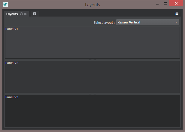

Vertical Resizer Layout
Used to display multiple panel vertically that can be resized individually and each contain their own content panel.
m.resizer.container({direction: 'vertical', redrawOnResize: false}, {className: 'fullscreen'}, [
    m.resizer.panel({'min-size': 50, ratio: 1}, [
            'Panel V1'
        m.layout.container({className: 'stingray-panel-mid stingray-border-dark'}, [
            'Panel V2'
        m.layout.container({className: 'stingray-panel-dark stingray-border-dark'}, [
            'Panel V3'

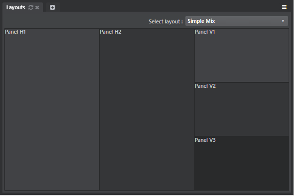

Mixed Simple Layout
Example of how we can easily mix simple layouts. This is an exact copy of the Vertical Layout placed inside the last panel of the Horizontal Layout.
m.layout.horizontal({}, [
    m.layout.panelFill({}, m.layout.container({className: 'stingray-panel stingray-border-dark'}, [
        'Panel H1'
    m.layout.panelFill({}, m.layout.container({className: 'stingray-panel-mid stingray-border-dark'}, [
        'Panel H2'
    m.layout.panelFill({}, m.layout.container({className: 'stingray-panel-dark'}, [
        /* Vertical Layout : This is an exact copy of the vertical layout */
            m.layout.vertical({}, [
                    'Panel V1'
                    'Panel V2'
                m.layout.panelFill({}, m.layout.container({className: 'stingray-panel-dark stingray-border-dark'}, [
                    'Panel V3'
        /* Vertical Layout : End*/

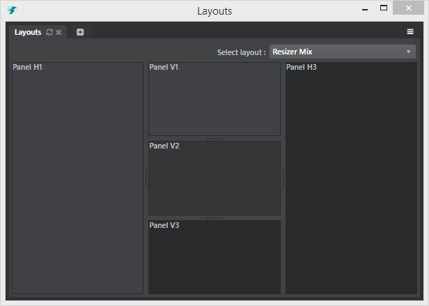

Mixed Resizers Layout
Example of how we can easily mix both types of resizers. This is an exact copy of the Vertical Resizer Layout placed inside the second panel of the Horizontal Resizer Layout.
m.resizer.container({direction: 'horizontal', redrawOnResize: false}, {className: 'fullscreen'}, [
            'Panel H1'
        /* Vertical Resizer Layout : This is an exact copy of the vertical resizer layout */
                        'Panel V1'
                        'Panel V2'
                        'Panel V3'
        /* Vertical Resizer Layout : End*/
            'Panel H3'
