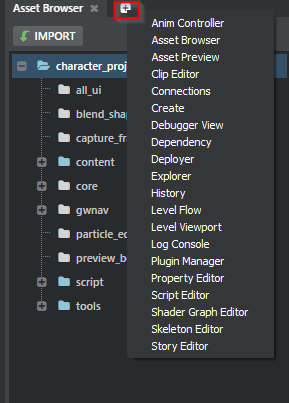

Note that if you register your view as a panel, it will also be available through the + button in any tab bar:

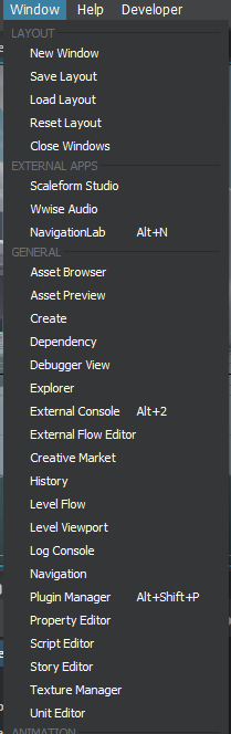

Most of the tools available under the General category in the Stingray Window menu come from named views that have been registered in a plug-in:
The stingray-editor.stingray_plugin file sets up a global action named open-view. You can use this action in your plug-in to pop open a named view from anywhere that you can run an action.

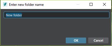

Like dockable panels, you can use the extensions/views module to open your dialog from anywhere in your plug-in's JavaScript code, and to get back its return value when the user closes the dialog:
~{js} // From asset-browser-controller.js function createNewFolder(uniqueDirectoryEntry) { return hostService.openModalTextInputDialog("Enter new folder name", uniqueDirectoryEntry.Filename); }
// From host-service.js
define([
'app',
'lodash',
'extensions/views'
], function (app, _, views, eventService) {
'use strict';
return {
openModalTextInputDialog = function (title, defaultValue, options) {
// Open the dialog called "text-input-dialog"
return views.openDialog('text-input-dialog', {
title,
defaultValue,
settings: options
}).then(function (result) {
// When the dialog is closed, if its result is valid (dialog hasn't been canceled) returns the
// dialog result to the caller
if (result.accepted)
return result.result.TextValue;
