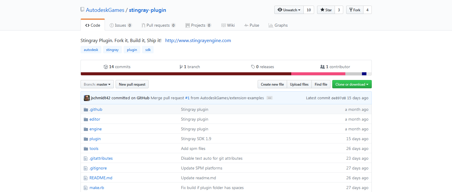

The stingray-plugin repository on GitHub is a great place to get started writing your own plug-ins. You'll find a framework all set up for you with some basic demo content, and all the tools you'll need to build libraries that extend the engine and the editor in C or C++.
For details on how to use this repository, see its main README.md file.
You'll also learn a ton by following along with the demo tutorial in the repository wiki. This walks you step-by-step through the process -- you'll use the plugin repo to build up a full-featured plug-in that extends all the parts of the Stingray environment: the project content, the editor, and the runtime engine.

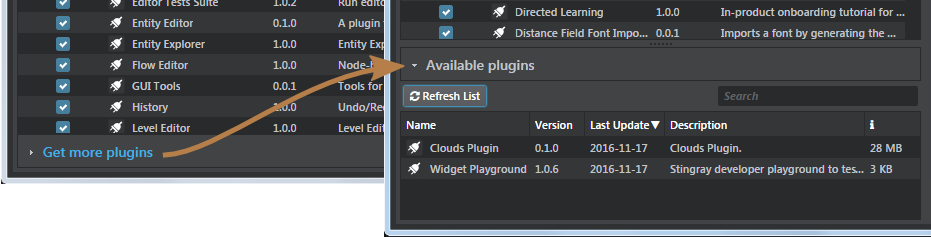

In the Plugin Manager panel of the Stingray editor, you'll find some additional plug-ins that aren't installed with Stingray by default, but which you can download and install with a single click. Look for the Get more plugins panel.
See also this page about using the Plugin Manager.
