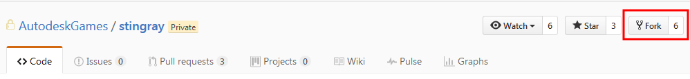

Create your own fork of the stingray repository, if you haven't already.
