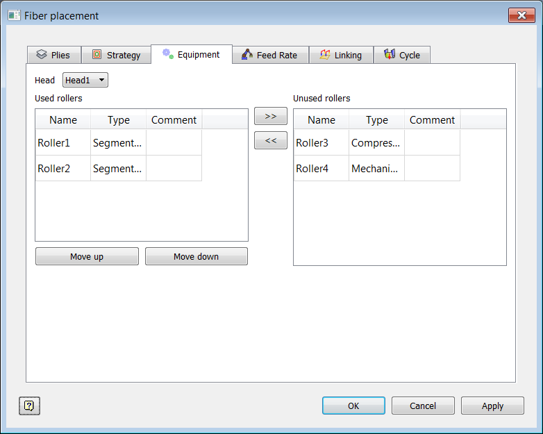

Equipment Tab
Use the Equipment tab to specify a set of rollers for a particular head. The heads and rollers available to you depend on the machine that is set up in your project.
  1. Select a head from the Head box.
  2. Use the Move Left and Move Right buttons to make a list of the rollers you want to use with that head.
  3. Click Move Up or Move Down to adjust the rollers’ positions on the head.
