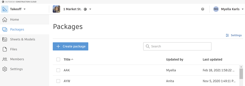

  1. In the left navigation, select Takeoff to open the Takeoff Packages list.
  2. Click the Create takeoff package button to open the Create package dialog box.
  3. Enter a title for the new package.
    • Takeoff packages are usually organized and named by their scope of work or trade divisions, but you can use any organization you prefer.
  4. Click the Create takeoff package button in the dialog box to create the package and add it to the list that shows all takeoff packages in your project.
