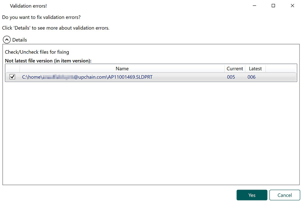

During the refresh, you also receive a validation window that outlines which files are not the latest version and what the latest version is.
mc-refresh-update-effective-date-validation-04
Click Yes to have Upchain retrieve the latest file versions for you, or click Cancel to continue using the older file versions. You do not have to update the file versions but it does mean that you are potentially working with outdated information.
