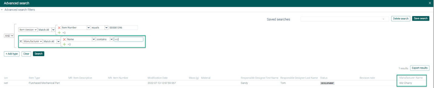

We removed Manufacturer Name as a column available for adding to the Advanced search results table. You can follow these steps so that manufacturer’s name does appear in the search results table:
Open Advanced search.
Configure one of the default search types: Item Version, File, Project, Customer, eBOM, CR, or CN.
Click + Add type.
Select Manufacturer from the drop-down list. The variable is automatically set to Name.
Select is not null from the operator drop-down list.
Click Search.
Manufacturer Name is available as a column in the search results table.
