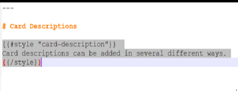

To add a description that also appears in the topic
Wrap the card description in a style helper
{{#style "card-description"}}
Such a card description appears both in the card topic as well as the card.
{{/style}}
