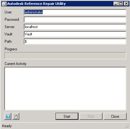

The first part of the repair reference workflow is to launch the Reference Repair Utility and configure your login credentials. You must also identify a Vault and specify the path to the folder that you want to scan for dangling relationships. When you are finished with these actions, continue on to Part 2 of the workflow.
Specify Login Information and Folder Path for Scanning
Files under the selected folder as well as those under the sub-folders (if any) are processed.
If you are repairing files in a replicated environment, it is best to heal on one site to avoid duplicate efforts. The Reference Repair Utility processes only files that are on that site. Files that are not yet replicated are not processed.
