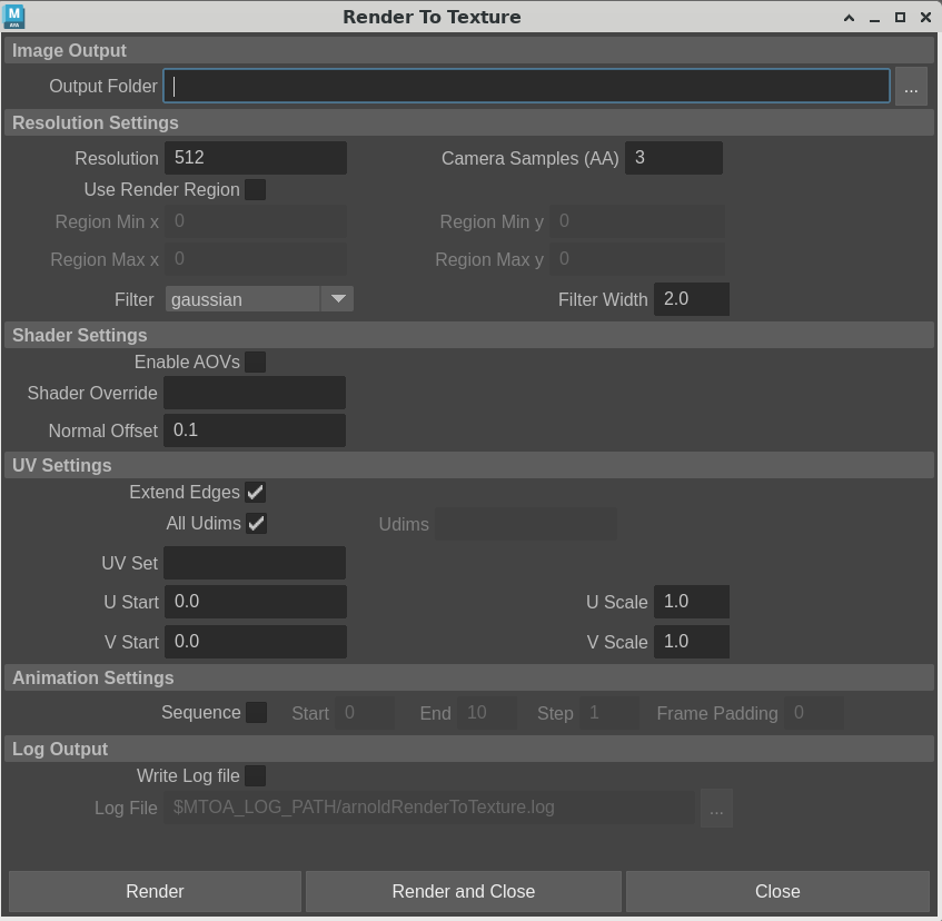

Render To Texture now supports USD stage selection - Users can now use Render To Texture on nodes inside the Maya USD stage. The UI has been improved to make it easier to use (MTOA-2180)
New Render To Texture UI

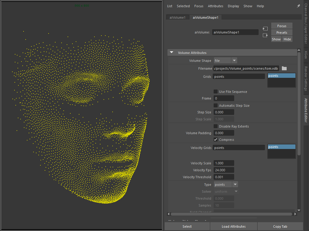

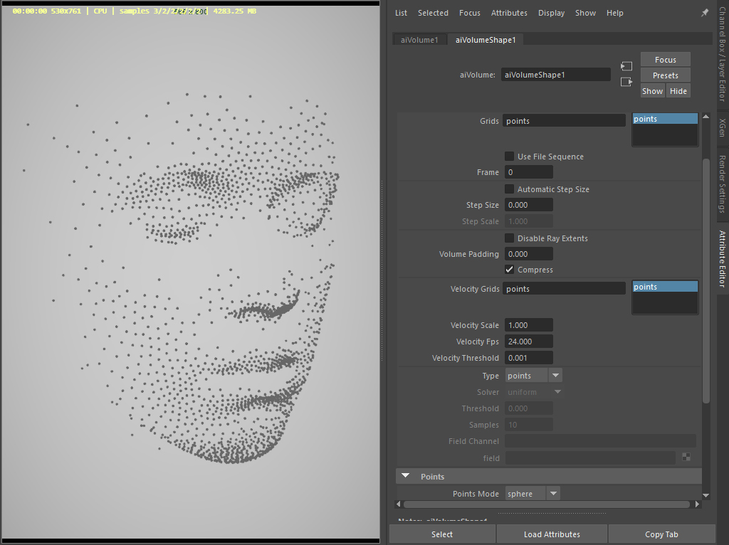

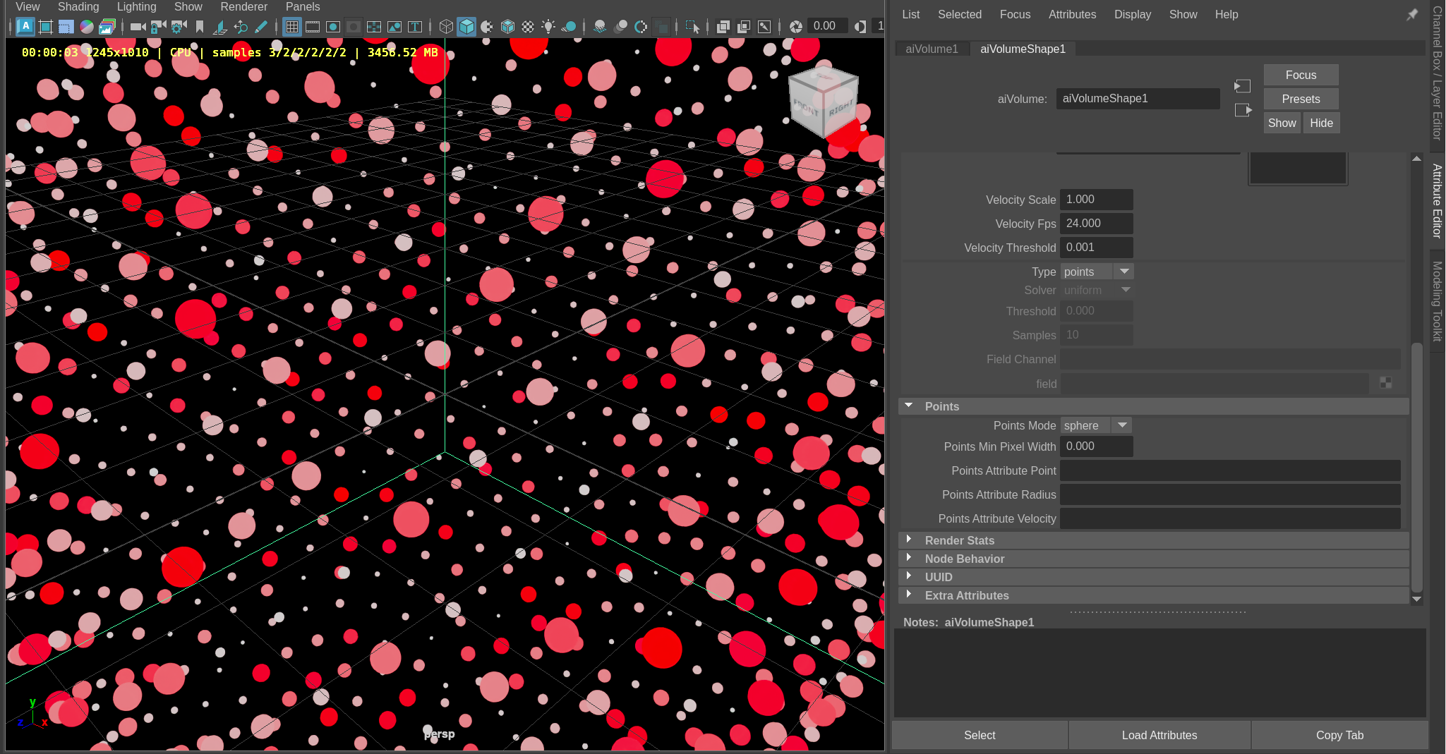

OpenVDB points support in the aiVolume node - You can now load VDB files that contain points data and render them as Arnold points primitives (MTOA-2234)
VBD points in aiVolume
Volume points displayed and rendered in the viewport

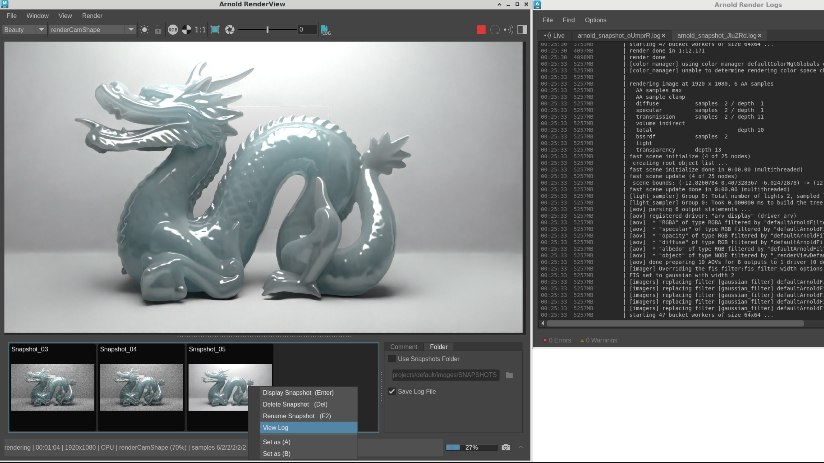

Render logs can now be saved with snapshots in Arnold Render View - When saving snapshots you can now save the current render log and view them in the Arnold Render Logs window (ARNOLD-12266)
Save logs with snapshots
