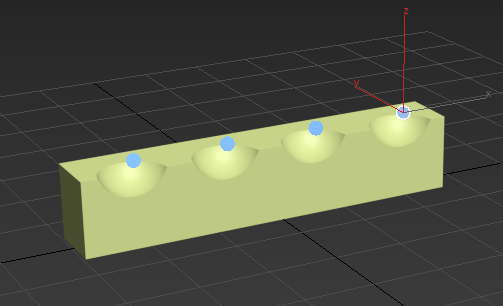

In the following examples, four spheres have been subtracted from a box.
Manipulate Operands is turned on, displaying blue operand handles.
Interface
- Display Selection
- Sets how the boolean operation is displayed in the viewport.
Note: In the following example, Manipulate Operands is turned on and the operand display mode is set to Wire and Shaded.
- Results: Displays the results of the boolean operation. No operands are visible.

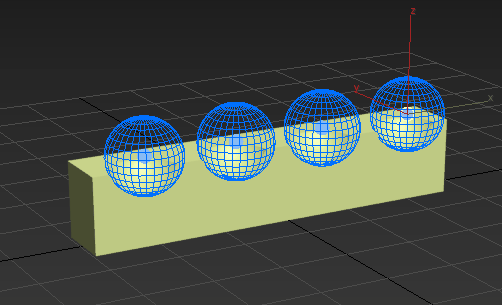

- Operands: Displays all the operands that are part of the selected boolean.

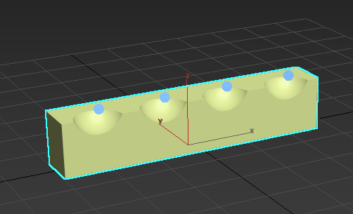

- Selected Operands: (Default) Displays an operand when it is selected in the viewport.

- Wire: Displays objects as a wire mesh

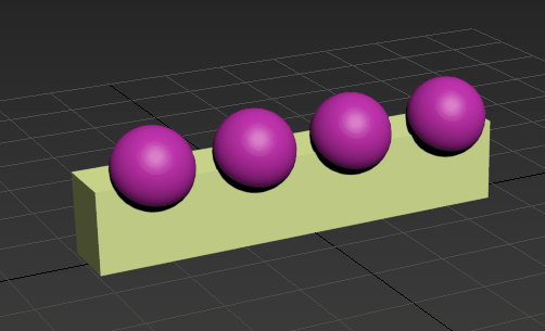

- Shaded: Displays objects with shading

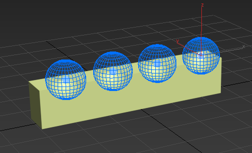

- Wire & Shaded: (Default) Displays objects as a wire mesh with shading

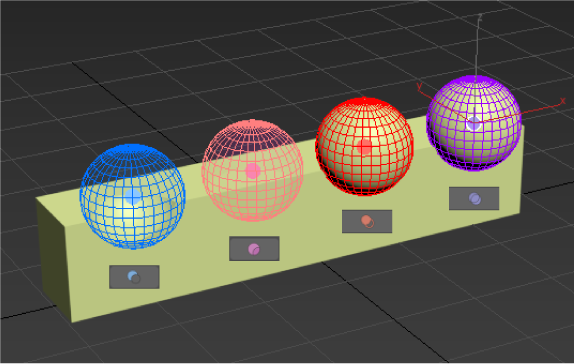

- The color of the operand's wireframe and manipulator changes depending on the type of operation that is performed. In the following example, each operand is assigned a different boolean operation to illustrate this feature:
subtract
split
insert
, and
merge
