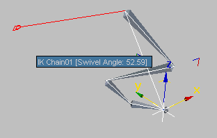

Manipulator for the Swivel Angle
You can adjust the swivel angle with the spinner in this rollout, or you can adjust it with a manipulator. To do so, turn on Select and Manipulate. The swivel angle manipulator is displayed as a handle in the viewports.
Swivel angle manipulator.
When you move the mouse over the manipulator, it turns red. At this point, you can drag the manipulator to change the swivel angle. The Auto Key button can be active while you do this.

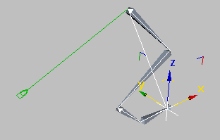

You can also animate the swivel angle by using a target object. Pick an object for the target, then animating the object will animate the swivel angle.
