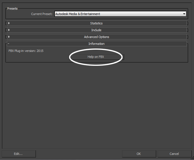

- Help
Click the Help on FBX button in the information rollout to access the 3ds Max FBX plug-in documentation.

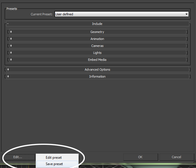

- Edit
You can use the Edit preset button to create and save custom presets with option settings that you define.
Access the Edit/Save preset options through the Edit button in the FBX plug-in UI.
The 3ds Max FBX plug-in stores custom presets in a file so you can share them with other users. See Storing Presets for more information.
See Creating a Custom FBX Preset for information about how to create custom presets.
