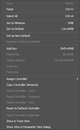

To open the spinner right-click menu, right-click the editable field of an animatable parameter. This menu provides options for cutting, copying, and pasting values, wires, and animation tracks between various object parameters. It also allows you to show the parameter in Track View or in the Parameter Wiring dialog.
Interface
With the exceptions of Undo and Select All, each of the following commands takes effect on the parameter you right-click. It's not necessary to first click in the value field. However, to use certain commands such as Copy and Delete, the value to be affected must first be highlighted.

- Add Key
- Adds a key on the current frame.
- Delete Key
- Deletes a key on the current frame.
- Delete All Keys
- Deletes all animation on the current parameter.
- Copy Key
- Copies the selected key to be pasted elsewhere.
- Paste Key
- Inserts copied key into the field.
- Assign Controller
- Shows a list of available controllers so you can assign an animation controller to the selected animatable parameter or track.
Note: An option to open the Assign Controller dialog appears at the bottom of the controllers list.
- Copy Controller
- Copies the animation controller, including all animation keys, to a buffer, which you can then assign elsewhere by pasting.
- Paste Controller - Copy
Assigns a copy of the controller in the buffer to the right-clicked field.
- Paste Controller - Instance
Assigns an instance of the copied controller to the right-clicked field.
- Paste Controller - Wire
Opens a Parameter Wiring dialog with the copied controller parameter and the paste destination parameter selected. This is equivalent to creating a wire parameter in the viewport between two parameters.
- Reset to Default Controller
- Reverts the current controller to the value specified as default.
- Copy Animation
- Paste Animation - Copy
Assigns a copy of animation controller in the buffer to the right-clicked field.
- Paste Animation - Instance
Assigns an instance of the copied animation controller to the right-clicked field.
- Paste Animation - Wire
Opens a Parameter Wiring dialog with the copied parameter and the paste destination parameter selected. This is equivalent to creating a wire parameter in the viewport between two parameters.
- Edit Wire
Opens the Parameter Wiring dialog expanded and positioned to show the wire controller assigned to the selected parameter.
Note: Edit Wire is available only if a two-way connectionis currently applied on the right-clicked parameter. - Show in Track View
Opens a Track View - Curve Editor window, titled “Selected,” expanded and positioned to show the selected parameter. This is very useful for fast access to a particular curve or track.
- Show in Parameter Wire dialog
Opens a Parameter Wiring Dialog with a focus on the selected parameter.
