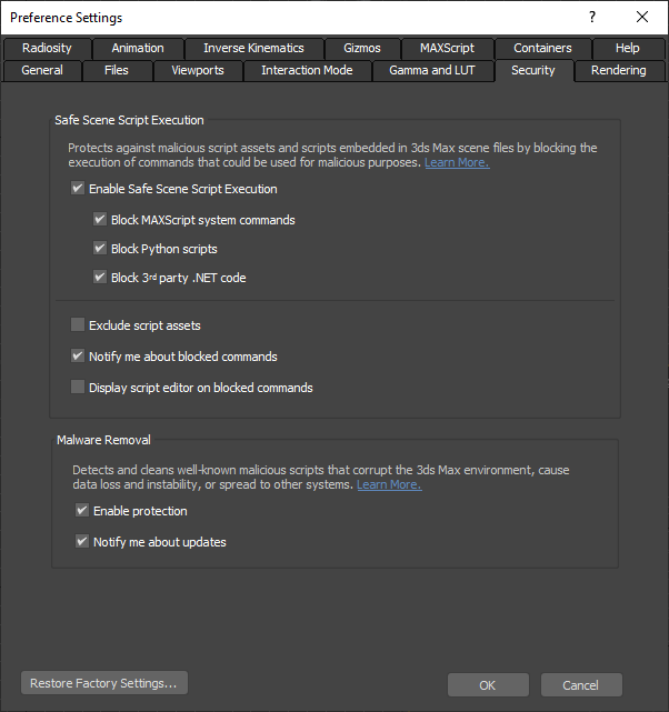

On the Security Panel of the Preferences Settings dialog, you set options for Safe Scene Script Execution.
- Default menu: Customize menu > Preferences > Preference Settings dialog > Security tab
- Alt menu: Customize menu > Customization > Preferences > Preference Settings dialog > Security tab
- Security Shield icon:
Interface
Safe Scene Script Execution protects against new and known malicious scripts by blocking the execution of commands deemed unsafe. Unlike Malware Removal, Safe Scene Script Execution does not remove malicious scripts. For the most complete protection we recommend that both Safe Scene Script Execution and Malware Removal are enabled at all times.
- Enable Safe Scene Execution
Enables the Safe Scene Script Execution feature which blocks the execution of some embedded script commands that are deemed unsafe.
Note: When you change this setting or any of the sub-settings, you need to re-start 3ds Max in order for the setting to take effect. A warning icon and message appears when you need to re-start.
- Block MAXScript System Commands
- Enables the blocking of MAXScript system commands only. These are commands that can launch operating system commands, manipulate OLE objects, or manipulate the Windows registry.
- Block Python Scripts
- Enables the blocking of all Python commands called from embedded scripts.
- Block 3rd Party .NET code
- Enables the blocking of the creation of certain .NET objects in embedded scripts.
- Exclude script assets
- Excludes "script assets" from Safe Scene Script Execution policies. These are scripts that have their path and file name embedded in a scene file, but not the script itself. Pre- and post-render scripts are examples of script assets.
- Display notification for blocked command
- When enabled, the Security Messages dialog is displayed whenever a command is blocked.
- Display script editor on blocked commands
- When enabled, the script editor containing the blocked command is displayed after the command blocked notification is displayed. Note that some embedded script types do not have an associated script editor.

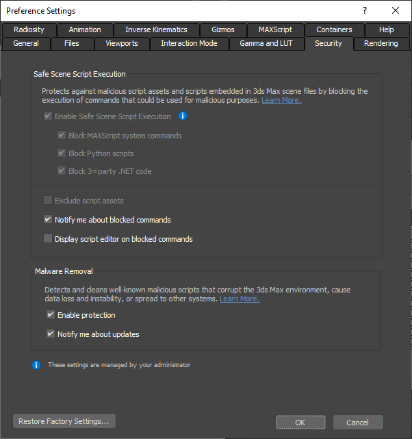

| System Administrator
Note: This setting is not required, but it must be set to "*CADAdmin" to disable settings via command line, environment variable, and Preferences UI. If it is not "*CADAdmin", or missing, the settings are only used if they are not present in 3dsmax.ini. |
Owner | string | *CADAdmin |
When a setting is controlled via the registry, it is disabled on the Preferences dialog, and an icon indicates it is managed by a system administrator. The setting cannot be changed via command line option or environment variable. Settings in the registry override settings specified on the command line or through environment variables.
Sample registry file to turn on all Safe Scene Script Execution options:
