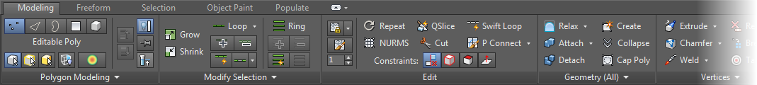

The Graphite Modeling Tools set is found on the ribbon. These tools give you a wide variety of features for editing polygon objects.
The ribbon contains all standard Edit/Editable Poly tools as well as additional tools for creating, selecting, and editing geometry. Also, you can customize the ribbon however you like. For details, see the following links.
