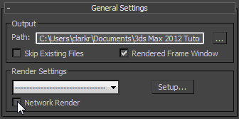

If you are using the Render To Texture dialog, then on the General Settings rollout click to turn on Network Render, and then click Render at the bottom of the dialog.
3ds Max opens the Network Job Assignment dialog, which lets you make final decisions about the job and submit your animation to the rendering servers.

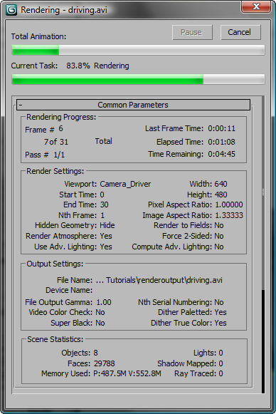

When network rendering begins on a rendering Server, the Rendering dialog appears on machines running serverapp.exe. If a machine is running the service version, no dialog appears.
