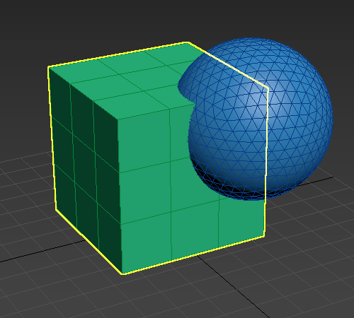

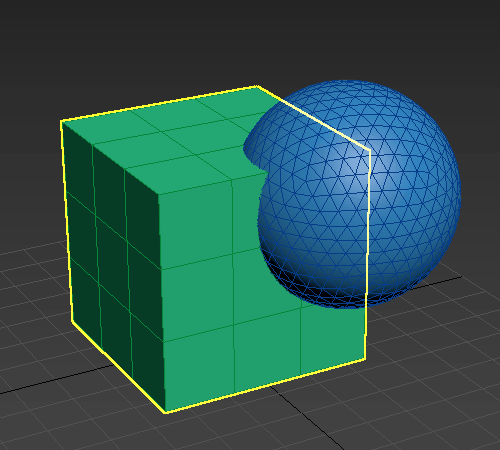

- Intersect
- Intersects the overlapping volume common to both original objects. The remaining geometry is discarded. Operands with Intersect applied are outlined in yellow when displayed in the viewport.

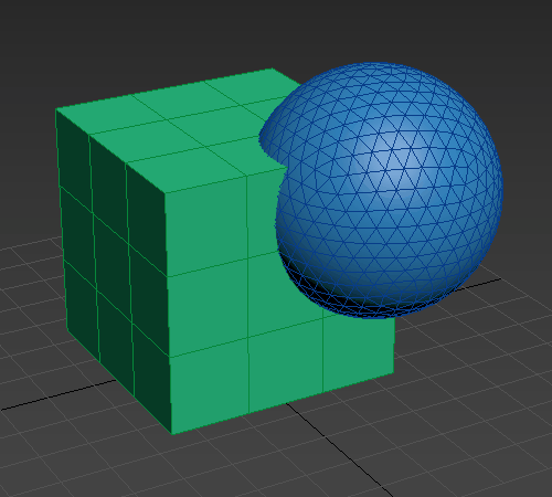

- Subtract
- Removes the intersecting volume from the base (originally selected) object. This operation is also known as difference. Operands with Subtract applied are outlined in blue when displayed in the viewport.

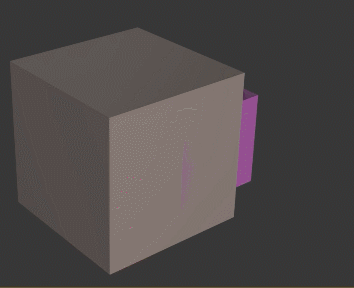

- Merge
- Intersects and combines two meshes without removing any of the original polygons. New edges are created where the objects intersect. This can be useful for cases in which you need to selectively remove parts of the mesh. Operands with Merge applied are outlined in purple when displayed in the viewport

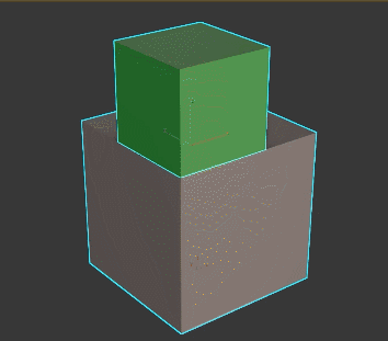

- Attach
- Combines multiple objects into one without affecting their topology; they remain essentially separate elements of the compound object. Operands with Attach applied are outlined in orange when displayed in the viewport.

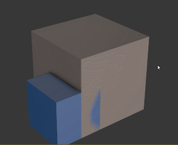

- Insert
Subtracts the bounding shape of Operand B (the newly added operand) from Operand A (the current result), leaving the shape of Operand B unaffected by the operation. Operands with Insert applied are outlined in red when displayed in the viewport.
Insert treats the first operand as a liquid volume, so that if there is a hole in the inserted operand or some other way for the 'liquid' to enter its volume, it does.

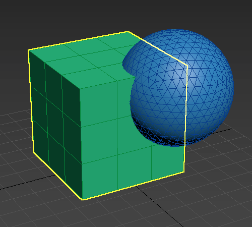

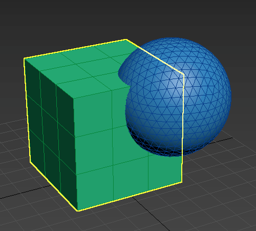

- Use Live Reference
- When off (default), incorporates the operand's geometry and transforms into the Boolean modifier. In other words, the operand is captured. As a result, the operand is hidden in the scene and is removed from the Scene Explorer. The operand is only accessible from the modifier stack. When captured operands are added to the
Operands list, a captured icon
is displayed next to the operand name.
- When on, operands are treated as live references. In this scenario, the operand's referenced geometry is hidden in the scene, but it is still accessible in the
Scene Explorer, allowing for more direct manipulation of the object.
Important: You must enable or disable Use Live Reference before adding operands. The checkbox has no effect on operands that have already been added to the Operands list.
- If you have a complex boolean with many operands, using live references may clutter the Scene Explorer. Additionally, when live references are included in your scene, each time the boolean recalculates it needs to evaluate every live reference, potentially slowing down your scene's performance. However, live references may be advantageous in a procedural animation context, where you need to animate particular operands.

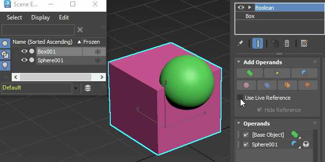

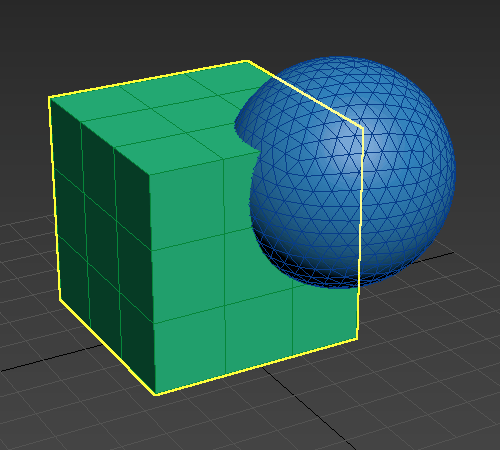

- In the following example,
Use Live Reference is enabled before adding the operand Sphere001, which is subtracted from Box001. Sphere001 is still accessible in the Scene Explorer after it's added to the Operand list.
