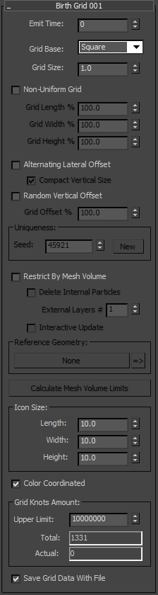

Interface
Birth Grid positions the particles it creates within a 3D, box-shaped grid. By default, the particles are evenly spaced; the overall spacing is determined by the Grid Size setting. The higher this value, the greater the spacing between particles, and vice-versa. To produce uneven spacing, turn on Non-Uniform Grid and use its three numeric settings to adjust spacing on individual axes as percentages of the overall spacing. Both Grid Size and, optionally, the Grid Length/Width/Height % settings specify particle density within the grid.
Conversely, the volume of the 3D grid is determined by the Icon Size settings (Length/Width/Height); these do not affect density. To achieve a grid shape other than a box, use Restrict By Mesh Volume with a mesh object. You can thus create a grid of any shape, filled or hollow (you can specify the shell thickness with the External Layers setting). By nesting objects in the Mesh Volume object, you can specify arbitrary layers of particles within the volume.
- Emit Time
- The frame number at which the operator emits all particles. Default=0.
Birth Grid generates all particles simultaneously at the frame defined by the Emit Time setting. To make the particles appear gradually, generate the particles in a birth event without a shape operator, then direct the particles in any fashion you like to another event containing a shape operator.

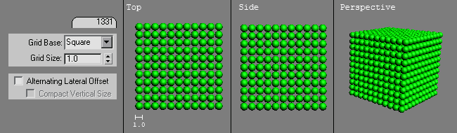

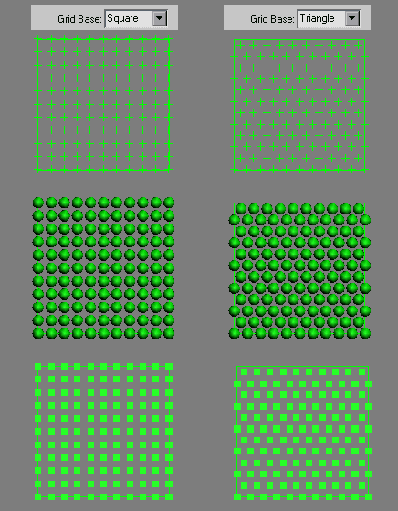

- Grid Base
- Choose how to pack the particles on a single grid layer: in a square or triangular layout. The two choices are depicted as viewed from the top in the following illustrations:
Square Triangle

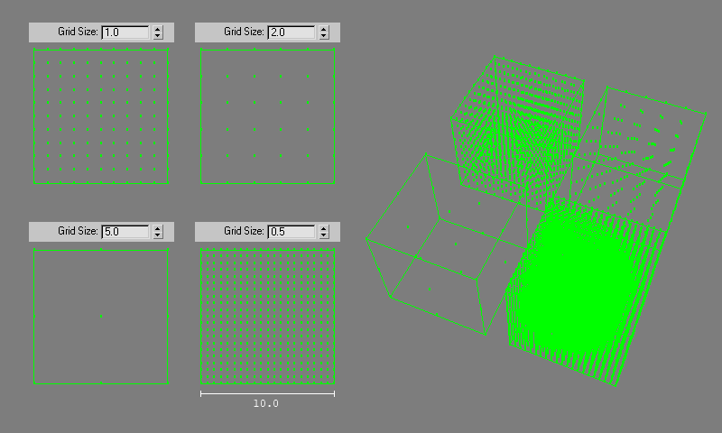

- Grid Size
- The distance between grid knots; each particle is born at a knot. When you use this parameter with Non-Uniform Grid off (see following), all knots are equidistant from one another.
Comparison of different Grid Size values

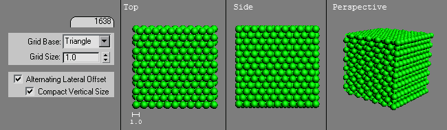

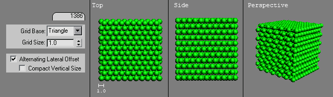

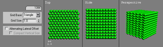

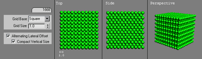

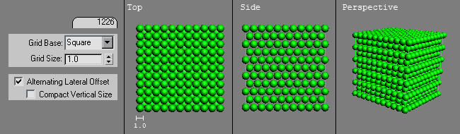

- Alternating Lateral Offset
- Places particles in more compact manner, similar to the way fruit is stacked at a produce stand. When on, makes Compact Vertical Size available.
- Compact Vertical Size
- Controls whether the vertical grid size is adjusted in order to make particles to stay more compact where grid size is not the distance between the layers but the distance between the particles of the layers.
For examples of using Alternating Lateral Offset and Compact Vertical Size with the different Grid Base options, see the following illustrations.

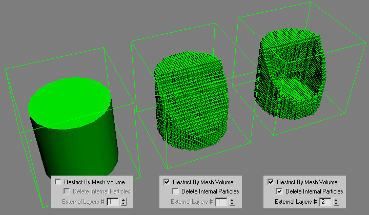

- Restrict By Mesh Volume
- When on, and you've specified the reference geometry (see following), Birth Grid generates particles only at grid-knot locations inside the reference object. This means, of course, that the reference object must be at least partially inside the operator icon.
Tip: Use this feature to create a particle array with the shape of a mesh object. With the Delete Internal Particles option (see following), the particle array can take the form of a shell that defines the object shape, such as in the following illustration:
You can also use nested mesh objects, combined into a single object with Attach, for layered shells. The way this works is that, when using Restrict By Mesh Volume, the operator places particles only inside each pair of concentric surfaces, so you can get hollowed-out sections without using Delete Internal Particles.
For the following illustration, we nested (from the inside out) two cylinders, a box, and a sphere. To get the open top and bottom, we reduced the Birth Grid icon height and positioned it so its top and bottom were inside the nested shapes' bounds.
Note: The process of determining which grid knots are inside of the reference geometry can be lengthy, depending on the number of grid knots and complexity of the mesh topology. During the calculations a running progress bar appears in the status line of the interface (near the bottom). To interrupt the calculations, click the Cancel button.Tip: If you change any parameters of the Birth Grid operator while the Restrict By Mesh Volume is enabled, you must click Calculate Mesh Volume Limits to see the effect.When Restrict By Mesh Volume is on, the following controls become available:
- Delete Internal Particles
- When on, generates only the outer layer of particles within the mesh volume.
- External Layers #
- the thickness, in particle layers, of the shell defined by the mesh volume.
