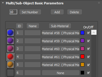

- A Multi/Sub-object material is assigned to the array used in the following examples. Five sub-materials are assigned solid colours:

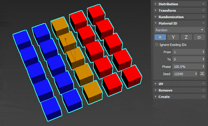

- Random:
- Material IDs are assigned to clones randomly based on a selected orientation:
- X: In the following example, IDs one, five, and four (1-blue, 5-orange, 4-red) appear randomly along the X-axis
- Y: In the following example, IDs one, five, and four (1-blue, 5-orange, 4-red) appear randomly along the Y-axis

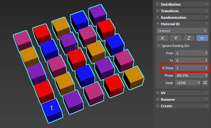

- ID: In the following example, CloneIDs are used for material ID assignment. When N Times is increased, the material ID is repeated.

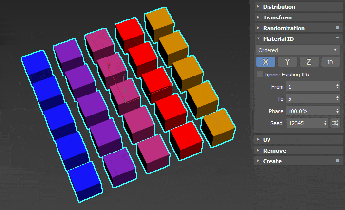

- Ordered
- Material IDs are assigned to clones in sequential order based on a selected orientation:
- X: In the following example, IDs one through five (1-blue, 2-purple, 3-pink, 4-red, 5-orange) appear in sequential order along the X-axis
- Y: In the following example, IDs one through five (1-blue, 2-purple, 3-pink, 4-red, 5-orange) appear in sequential order along the Y-axis

- ID: In the following example, CloneIDs are used for material ID assignment. When N Times is increased, the material ID is repeated on the adjacent clone.

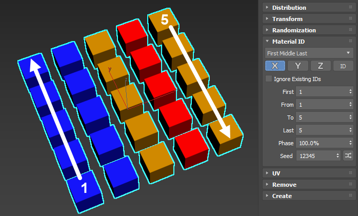

- X: In the following example, the
First clone (1) is assigned material ID one (blue) and the
Last clone (5) is assigned material ID five (orange). Other clones in these rows along the X-axis are also assigned the same material ID.

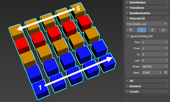

- Y: In the following example, the
Last clone (5) is assigned material ID five (orange). Other clones in these rows along the Y-axis are also assigned the same material ID.

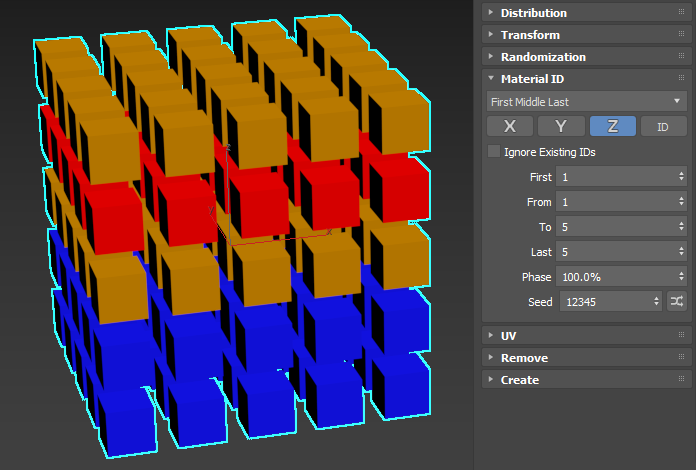

- Z: In the following example, the Count Z parameter has been adjusted, making the grid five clones tall. The
Last clone (5) is assigned material ID five (orange). Other clones in these rows along the Z-axis are also assigned the same material ID.

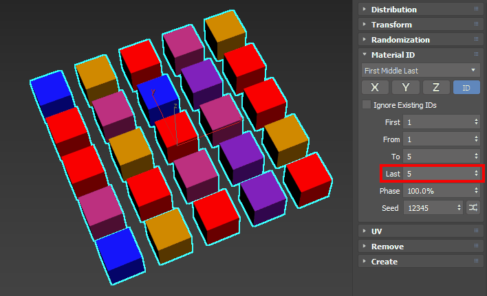

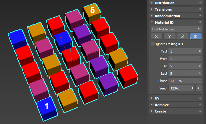

- ID: In the following example, the
Last clone (5) is assigned material ID five. The remaining clones' CloneIDs are used for material ID assignment.

- N Times
Is only available when the Random or Ordered method is selected and the orientation is set to ID.
Specifies the number of times each material ID is repeated in the array.

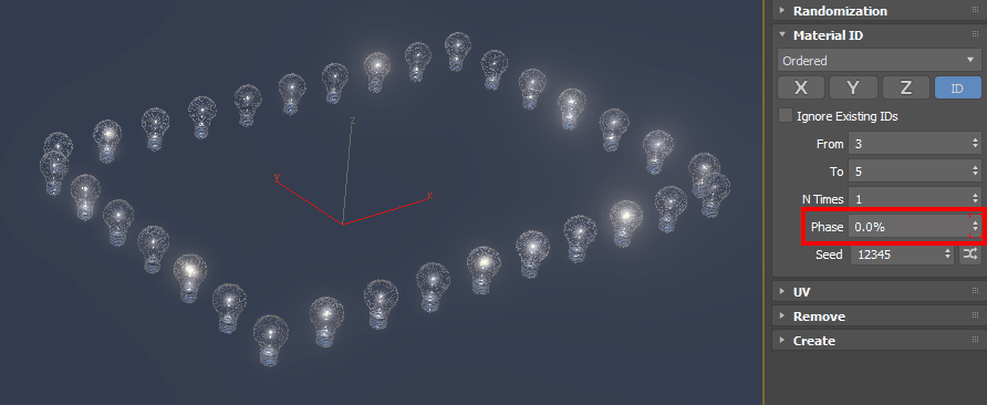

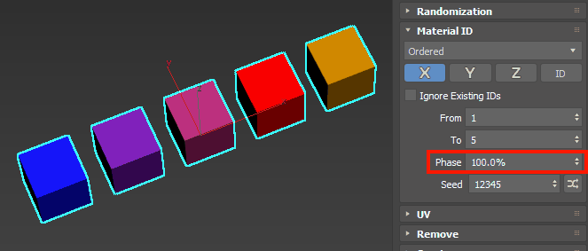

- Phase
- Cycles through the assigned material IDs.
- The following example shows how the clones cycle through material IDs one through five as the
Phase parameter is adjusted:
- Animating the Phase parameter can create interesting effects, as illustrated by this marquee. In this example, the Multi/Sub-object material assigned to this array has two different material IDs for the lightbulb filament: on and off. As the value of the Phase parameter changes, the material on the filament cycles from one clone to the next. When the Phase parameter is animated, the result is a glittering marquee.
