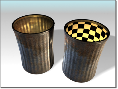

On the right, a double sided material creates a pattern for the inside of the trash can.

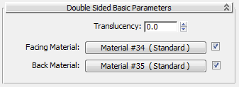

The Double Sided material controls let you choose the two materials, and the translucency of the material overall.
To choose the outer material, do one of the following:
  • Click the button labeled Facing Material.
    3ds Max displays the parameters for the sub-material. By default, a sub-material is a Standard material with Blinn shading.
  • In the Slate Material Editor, the default sub-materials appear as nodes in the active View. You can double-click either of these nodes to see and adjust the material parameters, or you can replace the Standard material nodes with nodes of a different type.
To choose the inner material, do one of the following:
  • Go back to the parent material (parameters for the Double Sided material). On the Double Sided Basic Parameters rollout, click the button labeled Back Material.
To control the blending of the two sub-materials:
  • Set Translucency to a value greater than 0.
    The Translucency control affects the blending of the two materials. When Translucency is 0, there is no blend. When Translucency is 100.0 percent, the outer material is visible on inner faces and the inner material is visible on outer faces. At intermediate values, the specified percentage of the inner material "bleeds through" and is visible on outer faces.
Interface
Translucency
Sets the amount that one material shows through the other. This is a percentage that can range from 0.0 to 100.0. At 100 percent, the outer material is visible on inner faces and the inner material is visible on outer faces. At intermediate values, the specified percentage of the inner material "bleeds through" and is visible on outer faces. Default=0.0.
You can animate this parameter.
Facing Material and Back Material
Click to display the Material/Map Browser and choose a material for one side or the other.
Use the checkboxes to turn the materials on or off.
