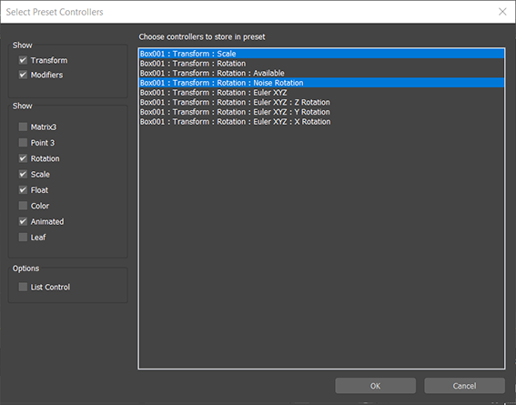

The Select Preset Controllers dialog

to open the Select Preset Controllers dialog. For this example, a box with a noise controller is used.
Box with a noise controller
- In the Select Preset Controllers dialog, choose the controllers you want to use in your Preset and click OK.

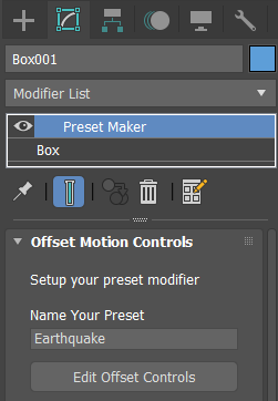

A new Preset Maker modifier appears in the modifier panel.
Note: You can only have one preset per node. - Name the Preset and click the Save Preset button. In the example, the Preset was named "Earthquake".
The Animation Preset is in your Project folder, under scene assets > animations > presets.
Preset Maker

Once the controllers you want to have an offset are selected, a modifier will be added that allows you to name the preset and adjust the time controls that you want. You can also add custom attributes to that preset modifier. Once this is done, and the modifier saved, the preset can be applied to anything.

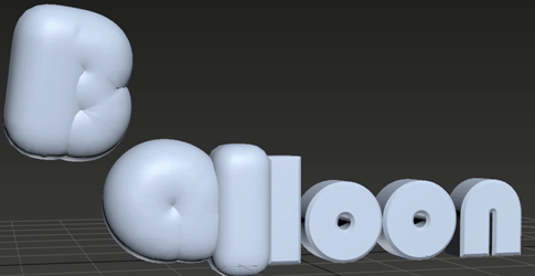

Presets allow you to create offset animations; for example, a balloon animation. If you wanted all your text to blow up like a balloon, you could use a smooth modifier, a relax modifier and a push modifier, and all those three modifiers would have the text blow up like a balloon.
You can build up a more complex set of instructions, save them, apply them as a preset, then apply the preset to other objects. You could then select each object and manipulate the controllers, such as time controllers and preset modifiers. For example, you can change the object's timing to be 5 frames instead of 10 frames, or, rather than the animation playing forward, to play backward
