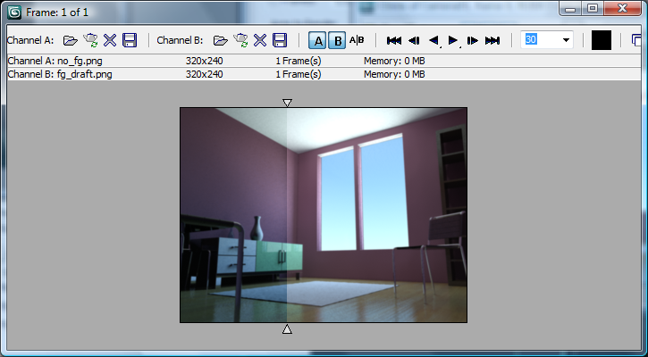

The RAM Player loads images and image sequences into RAM and displays them at different frame rates. The utility has two channels: A and B. You can load two different images or sequences into the channels to display or play back together, making it easy to compare them.
  • Default menu: Rendering menu > Compare Media in RAM Player
  • Alt menu: Rendering menu > Review Renderings > Compare Media in RAM Player
  • Design Ribbon > Lighting And Rendering tab > Render Tools panel > RAM Player
To set the position of the divider between the two channels, shown as triangles at opposite edges of the image, drag in the channel display window. To scrub the animation, drag with the right mouse button held down: rightward to advance and leftward to rewind.

When on, shows the file loaded into channel A. When both channels are enabled, split screen markers appear as two triangles. These markers indicate where channel A ends and channel B begins. You can move the divider with the left mouse button.
Channel B
When on, shows the file loaded into channel B. When both channels are enabled, split screen markers appear as two triangles. These markers indicate where channel A ends and channel B begins. You can move the divider with the left mouse button.
