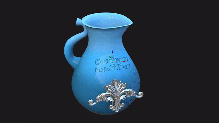

The Conform modifier lets you move a spline or mesh onto the surface of one or more other meshes.
The Conform modifier performs actions parametrically, letting you change the relationship between the conform object and the target surface after the initial conform operation has been performed. This lets you manipulate the look and feel of your model without any explicit modeling, like bending or shaping. As a result, you save time because basic modeling steps, like roughing out geometry and performing manual refinements, are eliminated.
You can also animate your deformations created with the Conform modifier. For example, a conform object can be animated as it moves across a target surface.

- Shrink Wrap: Shrinks the entire conform surface around the target, like wrapping a piece of cellophane (the conform object) around another object (the target object). As a result, the volume of the conform object is not preserved. Between the two different methods, Shrink Wrap is the most commonly used.
- Example: Attaching text to a target object, like a logo to the back of a car or a label on a bottle.
