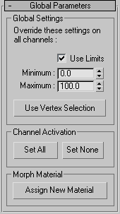

Global Parameters rollout
Global Settings group
- Use Limits
Use the minimum and maximum limits for all channels.
You can turn off limits to double purpose a target. The target for a smile can be used to turn the corners of the mouth down using negative values for example.
- Minimum
Sets the minimum limit.
- Maximum
Sets the maximum limit.
- Use Vertex Selection
Turn on to limit morphing to vertices selected in a modifier below the Morpher modifier in the modifier stack.
If your are using Character Studio Physique, limit morph animation on the base object to just the head and exclude the neck, for example. Place the Physique modifier above the Morpher modifier and assign the head vertices as rigid (green) in the Physique modifier.
Channel Activation group
- Set All
Click to activate all channels.
- Set None
Click to deactivate all channels.
Morph Material group
- Assign New Material
Click to assign the Morpher material to the base object (the object to which the Morpher modifier is applied).
To view and edit the assigned Morpher material, use the Material Editor. There is a direct correlation between the Channel Material Maps and the Channel list in the Morpher modifier (100 channels and 100 maps). For example, if channel 1 contains an eyebrows-up target and the Morpher material has a material assigned to map 1, then as the eyebrows are morphed, so is the material.
In the Morpher material, if a material is assigned to a map or channel that has no morph target in the Morpher modifier, you can use the channel spinner in the Morpher modifier to simply morph the material on a static object. See Mopher Material.

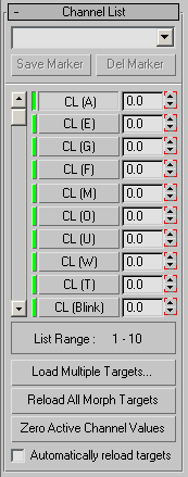

Channel List rollout
The upper section of the Channel List rollout contains controls for managing markers, which designate different locations in the list of morph targets. For example, channels 15 through 24 might contain all the emotion targets. Rather than scrolling to display these tracks, you can choose a marker from the list to display those channels.
- [marker drop-down list]
Choose a previously saved marker in the list, or enter a new name in the text field and click Save Marker to create a new marker.
For example, channel 15 through 24 might contain all the emotion targets. Rather than scrolling to display these tracks, you can choose a marker from the list to display these channels in the list.
- Save Marker
Move the scroll bar to frame a particular set of 10 channels, enter a name in the text field, and then click Save Marker to store the channel selection.
- Delete Marker
Choose a marker name to delete from the drop-down list, and then click Delete Marker to delete it.
- [channel list]
The Morpher modifier provides up to 100 morph channels. Scroll through the channels using the slider. Once you've assigned a morph target to a channel, the target's name appears in the channel list. Each channel has a percentage value field and a spinner to change the value.
You can change channel names and order in the Channel Parameters rollout.
Right-click a morph channel to display a right-click menu:
- Pick from Scene Choose this command and select an object in the viewports to assign a morph target to the channel.
- Delete Channel Deletes the morph data, name and parameters from the channel. Displays only if the channel has data.
- Reload Target Retrieves morph data from the target. Use this after editing a target.
- List Range
Displays the range of visible channels in the channel list.
- Load Multiple Targets
Load multiple morph targets into empty channels by selecting object names in the selection dialog and clicking Load.
If there are more targets than empty channels, a warning displays and the channels are not assigned.
- Reload All Morph Targets
Reloads all the morph targets.
If the targets have been edited, the channels are updated to reflect the changes. If a morph target has been deleted from the scene, then the morpher updates using the stored data in the channel, functions using the last stored morph data.
- Zero Active Channel Values
Click to create keys with a value of 0 for all active morph channels, if the Auto Key is on.
This is handy to prevent key interpolation from distorting the model. First click Zero Active Channel Values, and then set a particular channel to the value you want; only the altered channel affect the model.
- Automatically reload targets
Turn this on to allow animated targets to be updated dynamically by the Morpher modifier. There is a performance penalty when using this option.

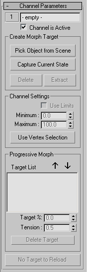

The channel number button and channel name field at the top of this rollout reflect the current active channel in the channel list.
- [channel number]
Click the number next to the channel name to display a menu. Use commands on the menu to group and organize channels, or to locate a channel.
- Move To Displays the Channel Operations dialog. To move the current channel to the selected channel, choose a channel from the list, and click Move To.
- Swap With Displays the Channel Operations dialog. To swap the current channel with the selected channel, choose a channel from the list, and click Swap With.
- Used Channels Displays a list of active channels. Choose a channel to place it at the top of the channel list display in the Channel List rollout.
- Channel Name
Displays the name of the current target. Change the name of the target in the text field if necessary. Parameter changes in the Channel Parameters rollout affect the current target.
- Channel is Active
Toggles a channel on and off. Inactive channels do not affect the morph result. Use this control to turn off certain channels to focus on animating other channels.
Create Morph Target group
- Pick Object from Scene
Turn on and click an object in the viewports to assign a morph target to the current channel. Picking an object adds it to the Progressive Morph list.
- Capture Current State
Choose an empty channel to activate this function. Click to create a target using the current channel values.
The captured channel is always blue because there is morph data but no specific geometry. Use Extract to create a mesh copy of the captured state.
- Delete
Deletes the target assignment for the current channel.
- Extract
Choose a blue channel and click this option to create an object from the morph data.
If you have used Capture Current State to take a snapshot of a group of channel values, but then want to edit it, use Extract to make a new object, pick it as the channel's target, and then start editing.
Channel Settings group
- Use Limits
Turn on to use limits on the current channel if Use Limits is turned off in the Global Parameters rollout.
- Minimum
Sets the lower limit.
- Maximum
Sets the upper limit.
Morphs only selected vertices on the current channel.
Progressive Morph group
Progressive morphing performs a tension-based interpolation, similar to the TCB animation controller, that creates smooth interpolation through each intermediary targets. This provides the artist with an unprecedented amount of control over the morph transformation.
Morphed object using multiple, intermediary targets
Morphed object using a single target
When morphing from one target to another, the object can sometimes pass through intermediary stages that are not desirable. For example, morphing a straight cylinder directly to a bent cylinder causes the cylinder to squash at intermediate stages.
You could get a better result by creating several intermediate morph targets for the object, and using them as channels. However, an easier solution is to create fewer intermediate targets, and use progressive morphing. With progressive morphing, you do not use the intermediate targets as channels; you use them to influence the end targets.
- Target List
Lists all intermediary morph targets associated with the current channel. To add morph targets to the list, click Pick Object from Scene.
- Move Up
Moves the selected intermediary morph target up in the list.
- Move Down
Moves the selected intermediary morph target down in the list.
Tip: For best results, move the original morph target (the one in the channel) to the bottom of the list. - Target %
Specifies how much the selected intermediate morph target contributes to the overall morph solution.
- Tension
Specifies the overall linearity of the vertex transformation between intermediary morph targets. A value of 1.0 creates a “loose” transition, causing the interpolation to overshoot each target slightly. A value of 0.0 creates a direct, linear transformation between each intermediary target.
- Delete Target
Deletes the selected intermediary morph target from the target list.
- Reload Morph Target
Reloads data from the current target into the channel. Reload a target if it has been adjusted or edited.
If the active morph target entry in the channel list is empty, this button is unavailable, and displays the text “No Target to Reload.”
