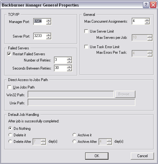

When you run Manager for the first time, you will see the Backburner Manager General Properties dialog, shown below; this is normal.
Backburner Manager General Properties dialog.
- Click OK to accept the default settings.
The Backburner Manager dialog displays.

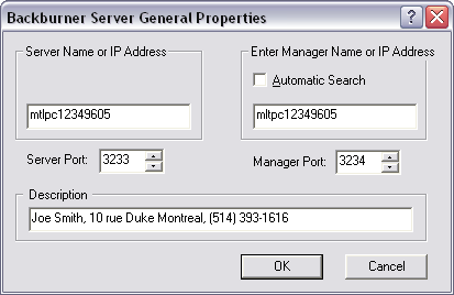

Server menu item.
This starts Server and creates the server data that is stored in the backburner.xml file.
You will see the Backburner Server General Properties dialog box, shown below, when you run Server for the first time.
Backburner Server General Properties dialog.
The Backburner Server dialog displays. After a few moments, messages appear in both the Server and Manager windows indicating that the Server has successfully registered with the Manager.

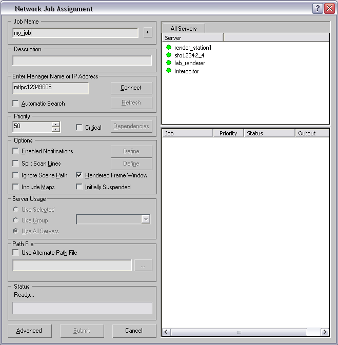

Network Job Assignment dialog showing all the server stations. The manager station is excluded.
- Enter a job name (it's a good idea to change the default name) and then click the Connect button.
The names of all Servers appear in the Server window to the right. Those with green dots next to their names are ready to start rendering.
By default, all the Servers that are listed will take part in the rendering job. To assign a specific Server to render a job, first turn off Use All Servers in the Options group, and then highlight the server(s) that you want to render the job.

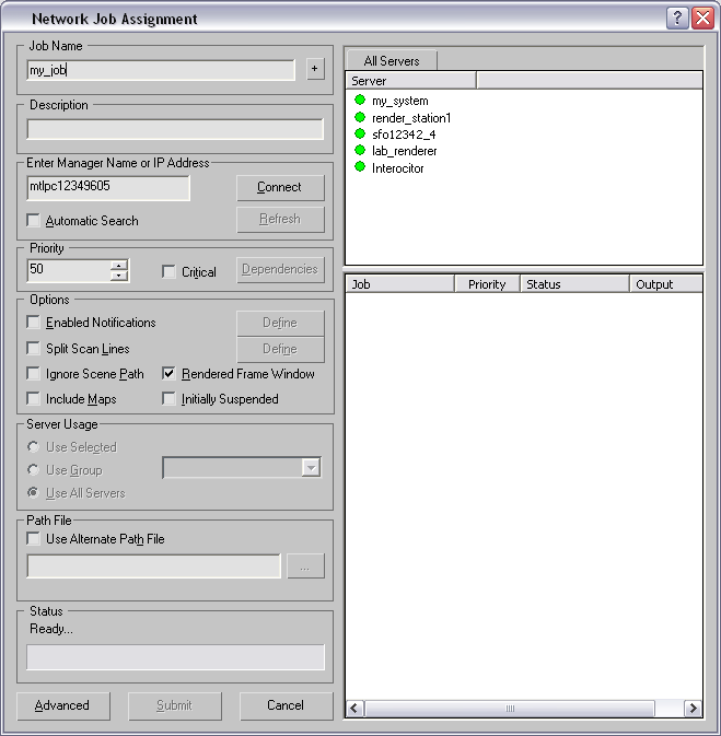

Network Job Assignment dialog showing all the server station plus the manager station that is running Server.
By default, all the Servers that are listed will take part in the rendering job. To assign a specific Server to render a job, first turn off Use All Servers in the Options group, and then highlight the server that you want to render the job.
