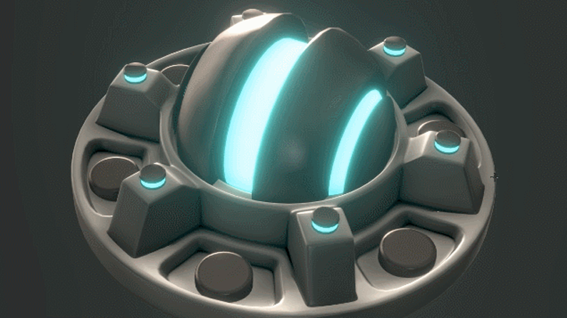

The updated Boolean Modifier includes improvements for performing volume based meshing tasks.
Volume based meshing
Perform volume based meshing with the
Boolean Modifier with greater ease using the following improvements:
