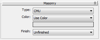

Masonry rollout
Type
Sets the type of the surface.
  • CMU (The default.)
  • Masonry
Color drop-down list
Sets the color of the surface.
  • Use Color (The default.) Sets the color of the material.
    Click the color swatch to change the color.
  • Use Map Maps the color of the material.

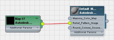

    Click the map button (or use Slate Material Editor node wiring) to assign a map to the material.
  • Color By Object Uses the object's 3ds Max wireframe color as the material color.
    Important: When you use Color By Object, the color appears in renderings, but not in viewports or material previews. This is because the material might be applied to multiple objects that have different wireframe colors.
Finish
Chooses the surface finish and reflectivity of the masonry.
  • Glossy
  • Matte
  • Unfinished (The default.)

Click to specify a bitmap for the relief pattern.
