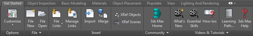

Get Started tab
Provides controls for customizing 3ds Max, starting a new scene—including the use of geometry from other files—and access to learning resources.

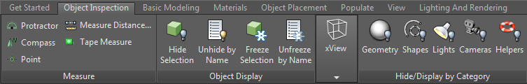

Object Inspection tab
Provides controls for exploring scene geometry and for controlling object display in viewports.

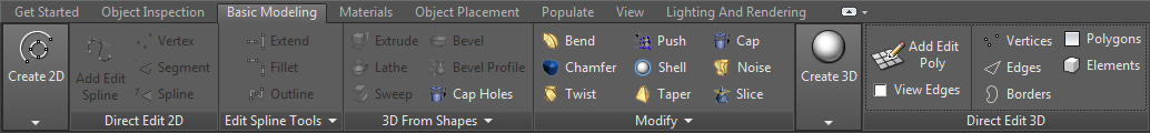

Basic Modeling tab
Provides tools for creating new geometry.

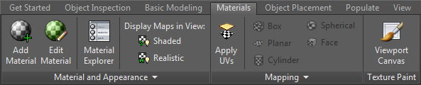

Materials tab
Provides tools for creating or editing materials, and managing them.

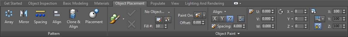

Object Placement tab
Provides tools for moving and placing objects.

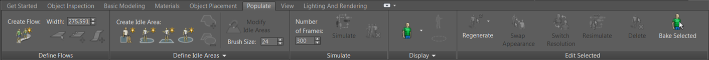

Populate tab
Provides tools for adding animated pedestrians and idlers to a scene.

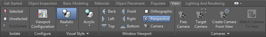

View tab
Provides tools for controlling viewport display; also for creating cameras.

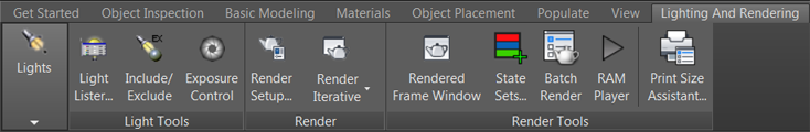

Lighting and Rendering tab
Provides tools for adding lights and creating renderings.
