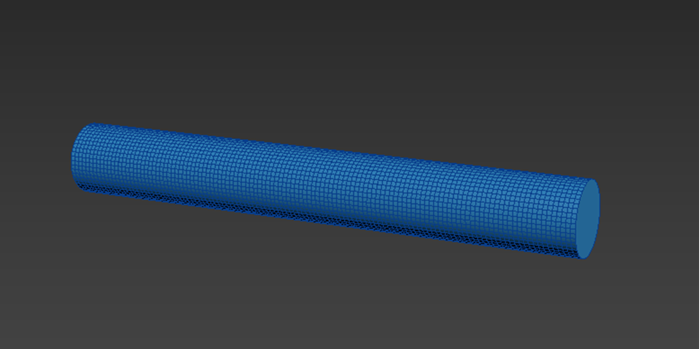

Create the conform object
In this example, a cylinder acts as the conform object.
- Create a cylinder (Cylinder001).
- In the
Parameters rollout, set the following values:
- Radius: 40
- Height: 600
- Height Segments: 120
- Sides: 50
- Select the Rotate tool.
- Select the
Transform Type-in (Edit > Transform Type-in) and set
Absolute:World
X value to 90.
This positions the cylinder on its side.

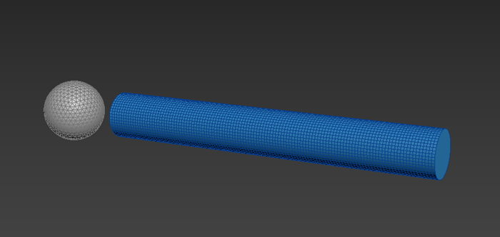

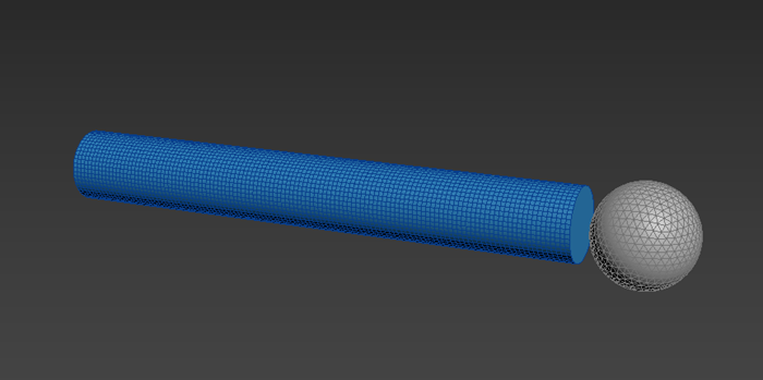

Create the target object
In this example, a geosphere acts as the target object, travelling through the cylinder.
- Create a geosphere (GeoSphere001).
- In the
Parameters rollout, set the following value:
- Radius: 55.0
Create an animation
- In the
Animation and Time Controls, turn on
Auto Key mode.
- Drag the time slider to 50.
- Move GeoSphere001 to the opposite end of Cylinder001.
- Drag the time slider back to 0.

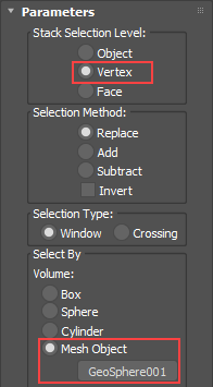

- In the Modify panel, selectVol. Select from the Modifier List.
- In the
- Stack Selection Level: Vertex
- Select By: Mesh Object; click the None button to select Geosphere001 in your scene.

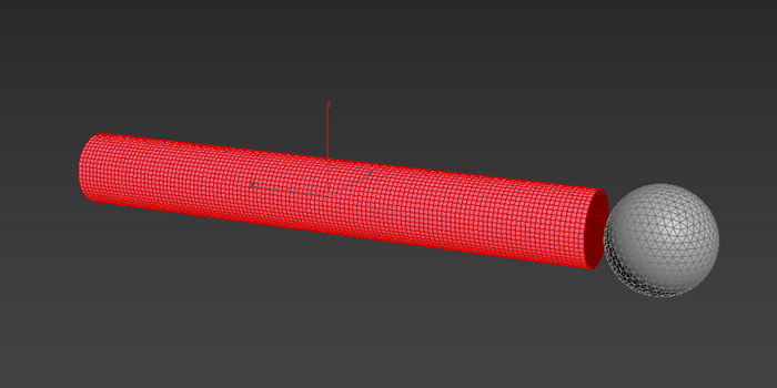

As the geosphere moves through the cylinder, vertices from Cylinder001 that are inside GeoSphere001 are selected.Tip: Turn on Wireframe Override in the Per-View Preference Viewport Label menu to better view this selection.

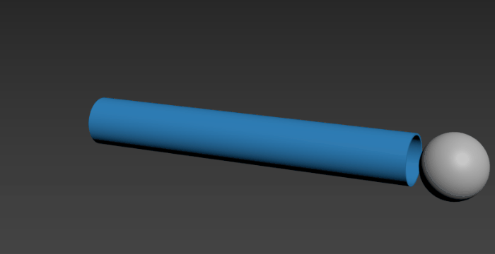

As the geosphere moves, the cylinder's selected vertices (red in the following example) conform to the surface of Geosphere001.Tip: Turn on Wireframe Override in the Per-View Preference Viewport Label menu to better view this selection.

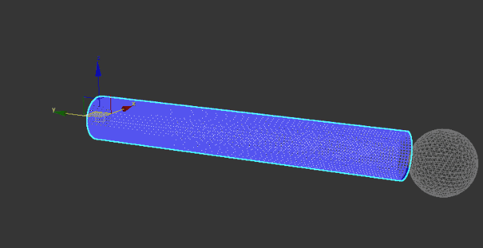

Now, any vertices that are directly in contact with GeoSphere001 are fully selected, while the selection of vertices in the area surrounding GeoSphere001 gradually decreases.Tip: Turn on Wireframe Override in the Per-View Preference Viewport Label menu to better view the selection.

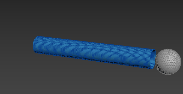

- Play the animation.
Geosphere is fully enveloped by the cylinder.
