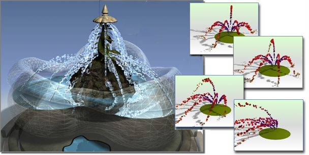

Left: Fountain spray created as a particle system
Insets on right: Wind space warp changes the direction of fountain spray
