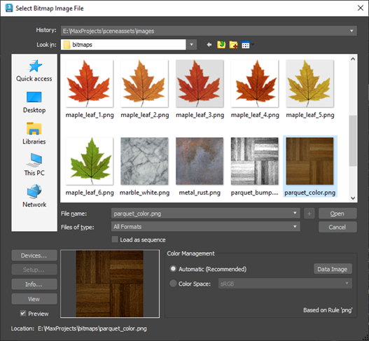

The Select Bitmap Image File dialog allows you to choose a file or sequence of files for a map. If a sequence of files is selected by turning on Sequence, the Image File List Control dialog is opened when you click Setup or Open.

- In the Select Bitmap Image dialog, use the Look In field to navigate to the appropriate directory.
Note: The Select Bitmap Image File dialog uses the last location where a bitmap was chosen, rather than the default bitmap path defined in Customize
Configure User Paths.
- Highlight the file name in the file list window.
- Click Open to close the dialog.

Interface
- History
- Displays a list of the most recent directories searched. Whenever an image is selected, the path used is added to the top of the history list as the most recently used path. The history information is saved in the 3dsmax.ini file.
- Look in
- Opens a navigation window to browse other directories or drives.
Go To Last Folder Visited - Click to return to the folder you previously browsed to.
Up One Level - Moves you up a level in the directory structure.
Create New Folder - Lets you create a new folder while in this dialog.
View Menu - Lets you choose the level of detail to display in the file list.
- Thumbnails: Displays the contents of a directory as thumbnails, without the details.
- Tiles: Displays the contents of a directory as large icons, without the details. If you widen the dialog, these tile across the width.
- Small Icons: Displays the contents of a directory as small icons, tiled across the width, without the details.
- List: Displays the contents of a directory without the details.
- Details: Displays the contents of a directory with full details such as size and date.
- [file list window]
- Lists the contents of the directory, in the format specified by the View menu.
Tip: When View Menu
Details is chosen, the contents of the directory are displayed with Name, Size, Type, Date Modified, and Attributes. You can sort based on each of these columns by clicking the column label.
- File name
- Displays the file name of the file selected in the list.
- Files of type
- Displays all the file types that can be displayed. This serves as a filter for the list.
- Load as sequence
- If there are more than one files that have the same root name and end in sequence numbers, turning
Load as sequence creates an Image File List (IFL). Default=off.
Each time you choose an image, 3ds Max checks to see if an IFL sequence can be created. If the selected image does not yield a list, this option is unavailable.
You can use wild-card characters to filter image files. When Load as sequence is turned on, you can click Setup to configure the IFL file.
- Open
- Selects the highlighted file and closes the dialog.
- Cancel
- Cancels the selection and closes the dialog.

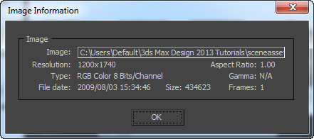

- Info
- Displays expanded information about the file, such as frame rate, compression quality, file size, and resolution. The information here depends on the type of information that is saved with the file type.
If the file has an embedded value, this dialog displays that value. Otherwise, it displays "N/A".

Color Management [OCIO color management modes only]
Declares the color space used by an image so that colors can be properly converted to the rendering space.
- Automatic (Recommended)
- Assigns the color space specified by the Automatic Color Space Assignment Rules. The assigned space is shown read-only in the Color Space box and the applicable rule is displayed below. The rules can be viewed or edited in your Color Management Settings.
- Color Space
- Sets an input color space for the image file. Use this only if the space assigned by the rules is not the space used by the image.
- Data Image
- Sets the Color Space to Raw. Use this for files that contain non-color data, such as normal maps, weight maps, and so on.
