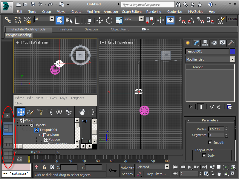

Viewport Layouts gives you a special tab bar for switching quickly among any number of different viewport layouts. For example, you might have a four-viewport layout, zoomed out for an overall view of your scene from different angles simultaneously, plus several different full-screen closeup views of different parts of the scene. The ability to activate any of these with a single click can speed your workflow tremendously. The layouts are saved with the scene so you can return to your custom viewports setup at any time.
Viewport Layouts tabs at bottom-left, showing three tabs below the Presets menu button
The Viewport Layouts tab bar is open by default when you first start 3ds Max, oriented vertically on the left side of the viewports. The single tab at the bottom of the bar bears an icon that depicts the startup layout. You can add tabs to access additional layouts by choosing them from the Presets menu, which opens when you click the arrow button on the tab bar. After loading additional layouts onto the bar from the presets, you can switch to any layout by clicking its icon.
- Viewport Layout tabs You add these from the Presets (arrow) menu on the tab bar. You can customize any layout by navigating the viewports, changing point-of-view and rendering modes, and moving viewport boundaries. You can also set any viewport in any layout to Track View, Scene Explorer, or any other Extended Viewport option.
You can have as many different layouts in a scene as memory permits. Tabs you add in a session are saved and loaded with the scene. Saved data includes all pertinent aspects of each layout including viewport navigation settings and rendering modes.
- Layout Presets (Standard and Custom) Open the Presets menu by clicking the arrow button on the tab bar. By default, this menu contains 12 of the standard viewport layouts (see Layout Panel). To open a new layout, choose any preset by clicking it. This also adds a tab for the layout to the tab bar.
You can add a custom preset based on any existing tab by right-clicking the tab and choosing Save Configuration As Preset. The custom preset remembers the layout (number and arrangement of viewports) and the viewport points of view, and when the Nitrous display driver display driver is active, it also remembers the viewport rendering modes. The custom preset does not store view transforms (pan/orbit/zoom). Custom presets persist between sessions, and can be renamed and deleted.

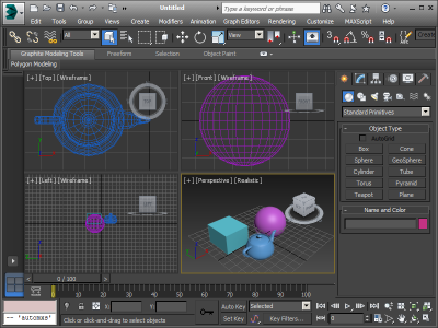

- Start 3ds Max. If the default layout isn't the standard 2 x 2 viewports, use the Layout panel to set it.
- Add a few different objects in the Perspective viewport, such as a teapot, a sphere, and a box.
All three objects appear in all four viewports.
- Use Zoom and Pan to fill the Top viewport with the teapot and the Front viewport with the sphere.
- Note the Viewport Layouts tab bar, the vertical bar to the left of the viewports. The bar contains a single tab, which represents the current layout. You'll add a layout by loading it from the available presets. Start by clicking the arrow button above the tab on the tab bar.

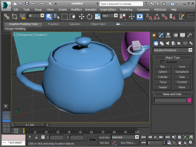

A new tab is added to the tab bar and its layout opens with a single, full-screen viewport. It uses the Top wireframe view because that's the default single-viewport view from the Layout panel.
Note: When you load a preset layout, it activates automatically. - Press the P key to switch it to a Perspective viewport and F3 to switch to a shaded view, then pan, zoom, and rotate the view so you're zoomed in on the teapot.
- Right-click the tab to open the context menu, then click in the Name field and change the name to Teapot Closeup.
Check the tooltip for the tab; it's the same as the layout name.
- Repeat steps 4-6 to create another closeup view for the sphere and name it Sphere Closeup.
