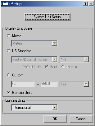

The Units Setup dialog establishes the unit display method, giving you the choice between generic units and standard units (feet and inches, or metric). You can also create custom units, which are used whenever you create an object.

Interface
System Unit Setup
Click to display the System Unit Setup dialog and change the system unit scale.
Warning: Change the system unit value only before importing or creating geometry. Do not change the system unit in an existing scene.
Display Unit Scale group
Choose a unit scale option (Metric, US Standard, Custom, or Generic Units) to activate its settings.
  • Metric Choose this option and then choose a metric unit: Millimeters, Centimeters, Meters, or Kilometers
  • US Standard Choose this option and then choose a US Standard unit. If you choose a fractional unit, the adjoining list activates to let you select the fractional component. The decimal units require no additional specification.
    The US Standards are as follows:
    • Fractional Inches
    • Decimal Inches
    • Fractional Feet
    • Decimal Feet
    • Feet w/ Fractional Inches
    • Feet w/ Decimal Inches
    For the last two items, you can specify which unit is assumed when you enter a value in a numeric field and press Enter without including a units specifier, such as ' for feet or " for inches.
    For example, if Feet is the default, typing 5 followed by Enter results in 5 feet. Typing 5" followed by Enter results in 0'5". If Inches is the default, typing 5 followed by Enter results in 0'5". Typing 5' followed by Enter results in 5 feet.
  • Custom Fill in the fields to define a custom unit of measurement.
  • Generic Units (The default.) A Generic or “system” unit in 3ds Max is equal to one inch. You can treat it as an arbitrary unit of your own definition, unless your scene uses features that depend on real-world measurements, such as photometric lights, Use Real-World Scale for bitmaps, and so on.
    Warning: If you are modeling an object that includes details whose dimensions are very much less than one inch, treat the Generic unit as an arbitrary unit that is smaller than one inch: for example, 1 unit = 1/50 of an inch. Otherwise, you might encounter problems with your model that are due to roundoff error.
Lighting Units group
Use the drop-down list to choose whether light values are displayed in American or International units.
