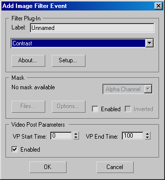

An Add Image Filter Event dialog appears.
- Choose the kind of filter you want from the Filter Plug-In list.
- If the Setup button is enabled for this kind of filter, click Setup to set the filter options.
- Choose a mask if you want the filter to be masked or if the kind of filter you're using requires it.
- Adjust other Image Filter settings, and then click OK.
If you selected a child event, the Image Filter event becomes its parent. If no event was selected, the Image Filter event appears at the end of the queue.

The Add Image Filter Event and Edit Filter Event dialogs have the same controls.
Filter Plug-In group
- Label
- Lets you give the event a unique name. A unique name can make the filter event easier to distinguish in a long list of events.
- [filter drop-down list]
- Lists the filter plug-ins you have installed.
See the separate help topics for a description of the filters that come with 3ds Max by clicking any of the filters listed above.
- About
- Provides version and source information specific to the plug-in.
- Setup
- Displays a setup dialog specific to the plug-in. Some plug-ins might not use this button.
Mask group
- [channels drop-down list]
- If you are using a bitmap as the mask file, you can use the Alpha channel, the Red, Green, or Blue channel, Luminance, Z-Buffer, Material ID channel, or Object ID.
- Files
- Select a file to use as a mask. The name of the selected file appears above the Files button.
- Options
- Displays an Image Input Options dialog where you can set alignment and size, relative to the frames of video output. For animated images, you can also synchronize the mask with the frame sequence of video output. This is the same dialog used for Image Input Event options.
- Enabled
- Enables the mask. If turned off, Video Post ignores any other mask settings.
- Inverted
- When turned on, the mask is inverted.
Video Post Parameters group
- VP Start Time/End Time
- Set the starting and ending frames for the selected event within the overall Video Post queue. Video Post renders the event over the number of frames specified here.
- Enabled
- Enables or disables the event. When turned off, the event is disabled and Video Post ignores it when rendering the queue. Each event must be disabled individually. For example, disabling a composite layer event does not disable the composited image events. The range bars of disabled events are unavailable in the event track area.
