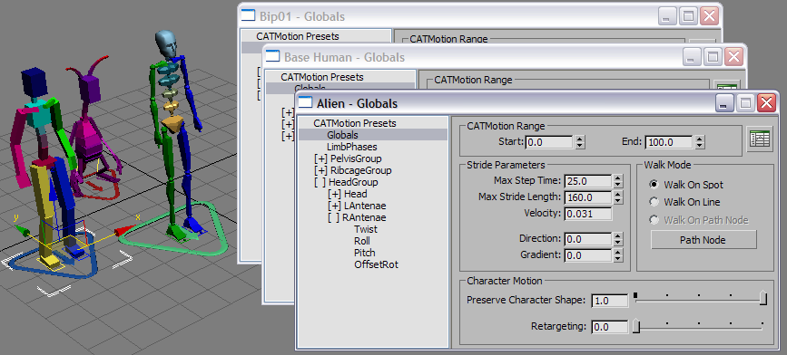

A separate editor window for each rig in the scene
You can open a separate window for each CATRig in your scene and edit settings at any time without having to reselect the rig. This is convenient when working with multiple rigs.

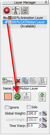

To open a CATMotion Editor dialog, click
CATMotion Editor on the Layer Manager rollout. This button replaces the Display Layer Transform Gizmo button when a CATMotion layer is highlighted in the layers list.
The CATMotion Editor button is available only when a CATMotion layer is highlighted in the layer stack.
The editor dialog comprises two panels: On the left is the CATRig hierarchy, which mirrors the rig structure and includes the CATMotion controllers, and on the right is a control panel for the item currently highlighted in the hierarchy.
The first three items in the hierarchy list are found in every CATRig: CATMotion Presets, Globals, and LimbPhases. The remaining hierarchy is organized by HubGroup.
