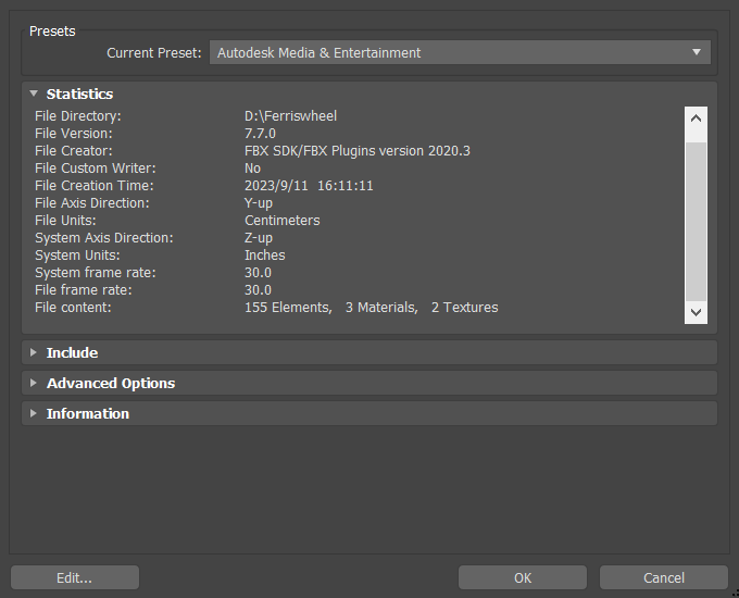

This section describes how to import files using the 3ds Max FBX plug-in:
To import an FBX file:
- Launch 3ds Max.
- Select File menu
Import, and use the file browser to locate the FBX file you want to import.
- The FBX Importer window opens. Set the import options you want. For a description of the settings you can use, see:
- Click Ok.
- If conversions or errors occur during the import process, the Warning Manager reports them at the end of the import process. See
Shoe/Hide Warning Manager for information about the Warning Manager.
