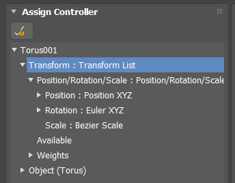

- Click the plus sign in the Position track to expand the track.
A Position XYZ track and a track labeled Available are now visible.

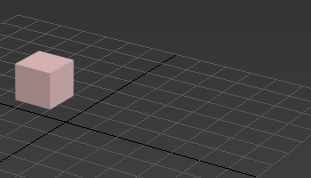

- Play
the animation.
The box follows the original animated path while vibrating randomly.

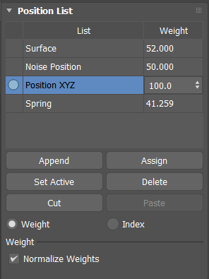

Motion panel > Parameters > Position List rollout

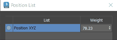

- List Window
Displays all the controllers in a list, with evaluation order from top to bottom. The controller at the top of the list is evaluated first; lower controllers are layered onto the result of higher controllers.
- Double-click the List name in the table to set active or rename. To add to list, assign a controller to 'Available' sub animatable.
- Double-click the
Weight value next to the controller to change the entry strength. Feeds into the chosen weighting method.
Exaggerate or minimize the effects of a controller by increasing or decreasing its weight value. Default = 100.0.
- Append
- Adds a new default controller to the end of the list. (You can set a new default controller by selecting a controller in the Assign Controller list and clicking the Make Default button.)

- Weight: Normalize Weights
Select the Weight option to activate the Weight setting:
When on, the weight values of all the controllers in the list are averaged. Available only for the Transform List, Position List, and Scale List controllers. Default=off.

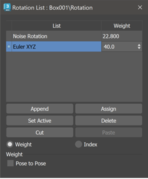

Motion panel > Parameters > Rotation List rollout
- Pose to Pose
Enables blending among controllers in the list. Available only for the Rotation List controller. Default=off.
When off, the List controller weights each rotation individually and adds up the weighted rotations for the final effect. You animate by stacking layers on top of layers, and then weighting in and out their effect. This is the default behavior.
When on, each pose is blended with the results from the previous controllers in the list. This method is not additive, but is instead true pose-to-pose blending. Adjusting the weight of a controller in the list will blend to and from that pose (controller in list). If the last weight is 100.0, then adjusting the weights of the previous poses in the list won't have any effect because the last pose has full effect. This is a stack-based approach that is best used for nonlinear animation (NLA) effects. You can paste motion clips or even single-frame poses onto new layers and use the weights to blend the poses together.

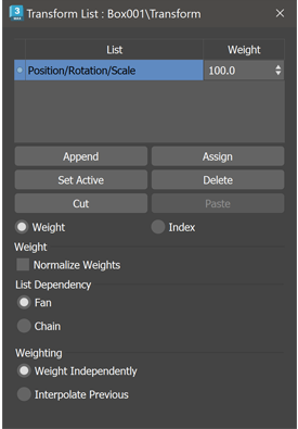

Motion panel > Parameters > Transform List rollout
- List Dependency
Use the List Dependency options to treat the list like a fan or a chain: is it order dependent, is an accurate parent transform needed?
Dependency Behavior Fan Passes the parent transform to list entries then blends together using the weighting method. This setting is useful when entries are independent and order doesn't matter. Chain Passes the previous result into the next as the parent transform, and then blends using the weighting method. This setting is useful when list is order dependent or when an accurate parent transform is needed, for example, with constraints - Weighting
- Choose how to apply weighting:
Weight type Behavior Weight Independently Weights list entries independently then combine. Rotation component weighting clamped between [-100%,100%]. Note: Avoid non-uniform scalingInterpolate Previous Interpolates the previous list entry with the current entry. Rotation is pose-to-pose interpolation like rotation_list (clamped [-100%,100%]). Scale weights the multiplied difference from previous. Note: Avoid non-uniform scaling
