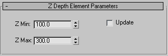

By default, the rendering includes objects near the front of the view (Z Min=100.0), and extends for 300 3ds Max units into the scene (Z Max=300.0). If your scene is deeper than 300 units, you need to increase the value of Z Max.
You can use the Update option to let 3ds Max automatically determine the depth extents of objects in the rendered view.
Z Min
The minimum distance to include in the Z-depth rendering. This is a value in 3ds Max units, and cannot be less than 0.0. Default=100.0
Z Max
The maximum distance to include in the Z-depth rendering. This is a value in 3ds Max units. Default=300.0
Update
Lets 3ds Max automatically determine the depth range of objects in the rendered view. When on, after completion of a rendering, 3ds Max changes the Z Min and Z Max values to reflect what the renderer determined. Typically, you would make a single test rendering with this on, and then turn off the checkbox.
