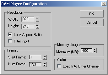

The RAM Player Configuration dialog contains controls for resolution, frames, memory usage, and alpha channel for playing back animations.
  • Default menu: Rendering menu > Compare Media in RAM Player > RAM Player dialog > Load a file into either channel. > RAM Player Configuration dialog
  • Alt menu: Rendering menu > Review Renderings > Compare Media in RAM Player > RAM Player dialog > Load a file into either channel. > RAM Player Configuration dialog
Resolution group
Width
The horizontal resolution, in pixels, at which the file is loaded.
Height
The vertical resolution, in pixels, at which the file is loaded.
Lock Aspect Ratio
When on, forces the file to load using its own aspect ratio, regardless of the specified Width and Height values.
If you change the Width value, the software adjusts the vertical resolution according to the file's original aspect ratio. Adjusting the Height does the same to the Width value.
Filter Input
When on, modifies the image or animation to maintain the quality of the original file. When turned off, filtering does not occur, and the image or animation could be distorted.
Frames group
Start Frame
Specifies a certain frame in an animation where the RAM Player should begin loading. A value of 1 starts the animation at its rendered beginning. A value of 5 would start the animation on frame five, discarding any preceding frames.
Num Frames
The total number of frames to be loaded into the RAM Player.
Memory Usage group
Maximum (MB)
Lets you configure the maximum amount of memory to use for the RAM player, in megabytes. This value includes both channels.
Alpha group
Load Into Other Channels
When on, loads a grayscale alpha channel into the other channel. This allows you to wipe between an RGB channel of the animation and the alpha channel of the animation.
